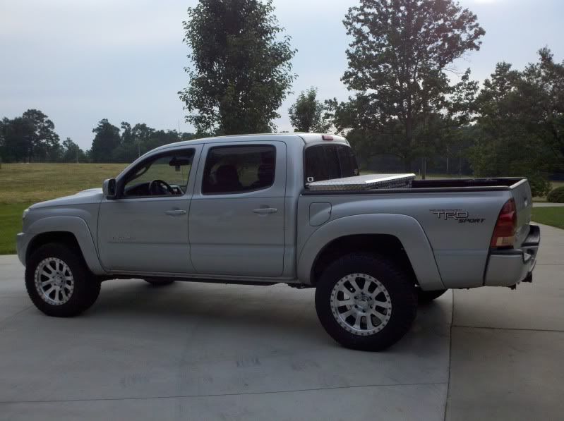

Installed 285/60/18 Cooper Zeon LTZ w/ Eagle Alloy 063 rims and now I'm rubbing
Not too happy since everywhee I had read said I wouldnt rub with this size tire and no lift. Guess I'll have to trim

It's all in your offset. I ran those tires on stock suspension with only the mud flaps removed and no trimming, and I had no rubbing issues.

Yeah its crazy. There's a guy on here with silver doublecab that has XD monsters and the same tires. I thought the offet on my wheels was the same as his cause he didnt rub. But apparently not.

I ordered the wheels through Mr. Wheel Deal, so I don't know the exact specifications of the rim. They are 18x9 and DO stick out about an 1.5 inches

Its a mystery I know. But I have trimmed quite a bit and have eliminated 80% of the rubbing I'd guess. I've gotten used to it, but it did suck having to cut up that truck, when I was so sure I wouldn't have to.
