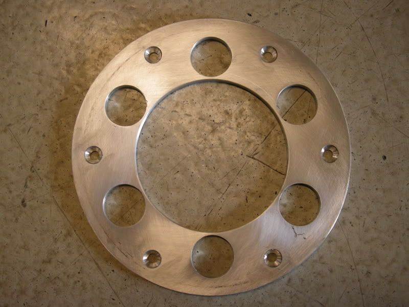

20 inch wheels, not so easy install...but damn I like how it looks
20X9 KMC Backseat
I ordered the wheels from ebay with a 78mm bore....oops
The hub sticks out ~11mm but I could not bore the wheel out that deep or it would hit the wheel spokes.....so my buddy made spacers from 1/4 aluminum plate....
Then bored out the wheel to 106mm, 6mm deep....giving a total of ~12-13mm depth when the spacer is installed with the 6 mounting screws.
I did a 3" AAL lift and installed 15mm longer wheel studs to account for the thicker wheels and spacers.
A bit harder than just a bolt on....but I think it looks good.

Handles better
Notice a little bit sluggish out of the hole, but not too bad
Braking feels the same.
Pulled my 2000+ lb ski and trailer over 400 miles and it had zero problems.
Wheels and spacers are hub-centric and balanced together, no problems.
I do have a bit more annoying bump steer than before the lift, I had it aligned the next day.
Are any correction kits available?
Maybe drop the center link a little to correct the tie-rod angle.
