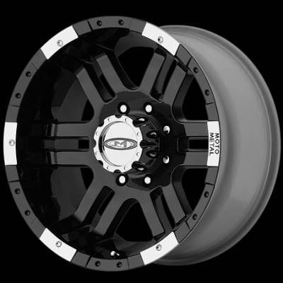

what size/lug pattern do i need if i order this wheel?
i have a 2012 double cab prerunner v6. i have 16 inch steel wheels. what size do i need to order as far as lug pattern goes. i think these are moto metal 951s. thanks i want to stick with 16 inch size. also, if i got a larger tire, what the biggest i can go on stock size.

this is a 16x8 wheel. my current wheel is 16x7

6 on 5.5

is that like 114.3?

I have these exact rims...here is the one you want. 16x8 with 6on5.5" bolt pattern, 0 offset and 4.5 BS

Just so you know, you will need new lugs as well. The set will cost you around $25.
