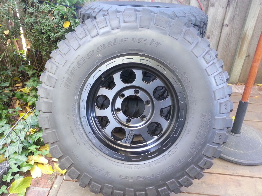

I have searched but could not find an answer, will these wheels fit my 04 Tacoma TRD 4x4 without using spacers? (16" Kmc Black Enduro rims)

The one's pictured, 255/85/16, I have an OME lift with Dakar's & AAL in the rear. I was mainly concerned about the rims hitting the front rotors, but if you see some other fit issues, your insight would be appreciated.

You'll be good to go. Those won't have any caliper issues, and the 255s won't interfere with the ucas.

I'm running those on my 04 TRD with 265's and OME lift, no rubbing.
You're good to go man.

OME lift, only rubbing was the pinch weld, beat it down, good to go. Oh yea, a little rubbing on the frame at full lock.

What size tires are those? I'm looking to get 265/75/16's. should I have rub issues with 265's?

Those are 255's I believe, however, I have 265/75's and don't have any rubbing issues.
