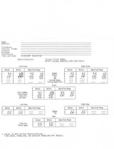

ok just got my new tires 285/75/16 m/t had a shake between 45-65mph brought it back to the tire shop had them re balance the tires but shake is still there....
i have 5100's at 2.5 --l.r. uca's & 2" aal..
my alingment is not perfect but it drives straight....on going alingment issues here with the lr uca's " no one knows or is willing to adjust them"
but does this shaking sound like an balance issue or and alingment issue...
i can feel it in the wheel and the gas pedal

Yea your alignment has nothing to do with this at all.

Alignment problems normally cause the vehicle to pull left or right, not shake. Shaking could also be caused by problems in the steering rack. I had that with my last Taco.
