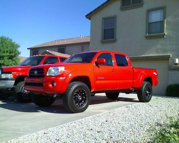

Ok guys, when I bought the wheels and tires back in May of 09, I was under the impression going up in size, would result in the tires sticking out a little. They don't obviously because of the type of wheel and back spacing the guy at Discount Tire ordered for me. They are 285/70 R17's. Are spacers a good idea to remedy this and what are the costs for all 4? Is this even a good idea?

What are the specs on the wheels you're running? They say 4.5 backspacing will make the wheels flush with the fender flares. If they stick out any further you risk getting your paint chipped up from shit flying off the tires.
Spidertrax is what most people use for spacers.

Yes, I believe the backspacing is 4.5, I should double check. The tires are flush with my oem flares.

But you want them out a little further for a more aggressive stance? If you get 1" spacers that would technically put you at a 3.5 backspacing. Thats a lot of tire exposed outside the truck.

Can you post a pic of your truck from the front and back to see how the tires/wheels sit?

I don't think I have any dead on front or rear shots in my gallery. I need to take some I guess.

And yes, I was thinking it would be a little more of an aggressive stance and possible more stability. Wondering about wheel bearing wear and tear though.
