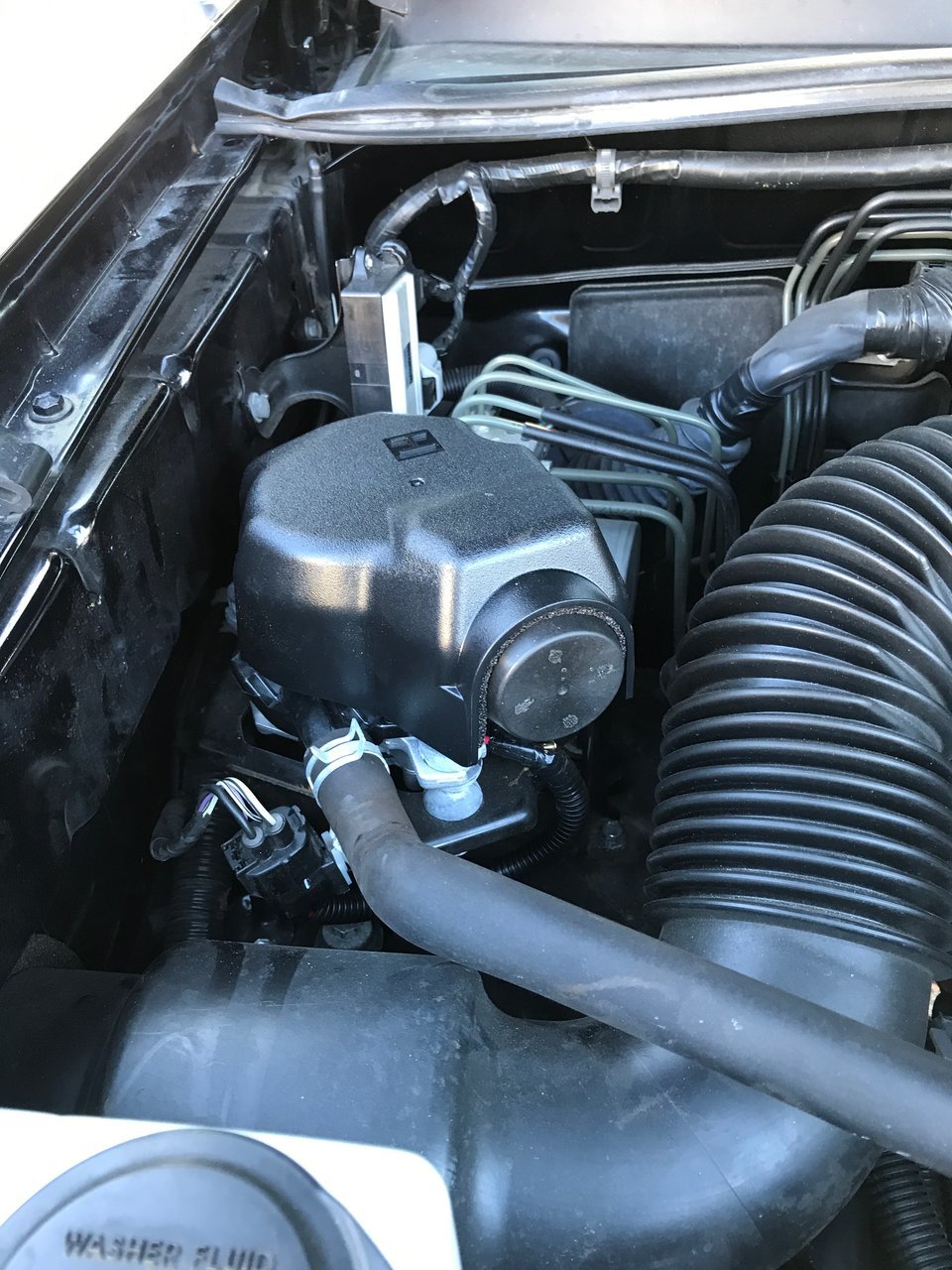

    I got CEL P2440 this week on my 2005 2.7L, I'm going to contact my local dealer to see if I can get covered; I ordered the parts from Norwalk Toyota and they're currently in the mail.
    I ordered the Valve and Pump Cover and the 1" Uni Filter off Amazon to remedy this myself.

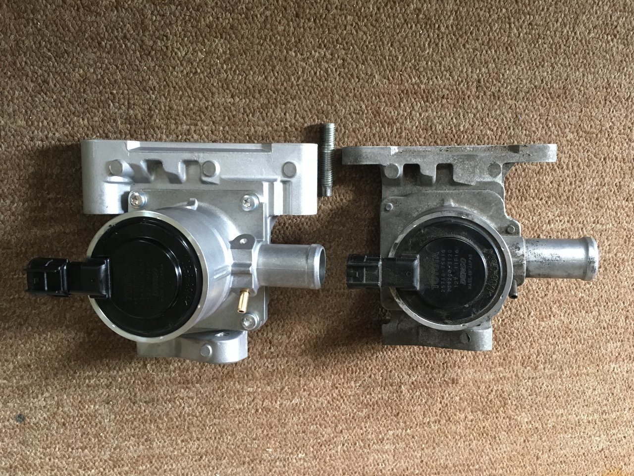

    I decided to just install myself.
    P/N 25710-75015
    Due to the thicker mounting flange the Studs must be replaced with P/N 90126-08031.

    So it is actually a different part. That's good to know.
