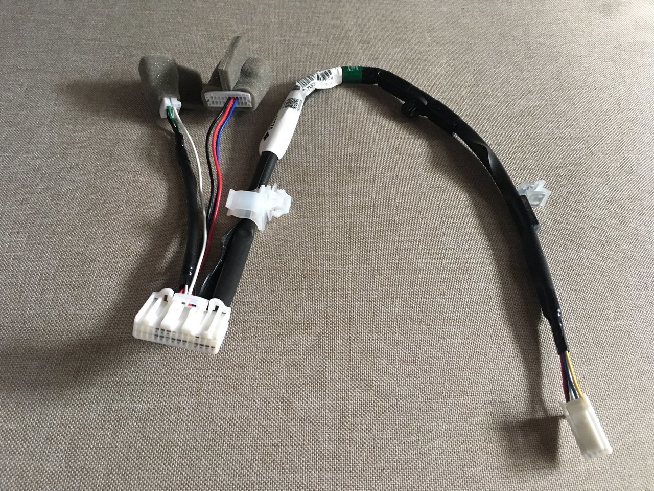

    I put this together adding an Entune Plus 6.1" from a 2017 to my 2005
    20pin (steering wheel controls) + 8pin (microphone) + Aux to 28pin harness
    The USB lightening cable recognizes my 5 SE as an iPhone and AUX works perfectly
    Also part of Aux + USB harness
