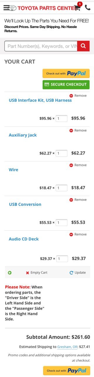

    I updated my 2005 radio to a 2017 6.1" and put this together to get Aux/USB. As popular of an upgrade as it is, I put together a second one. On hand and ready to ship.
    Add AUX & USB to your stock radio
    2005-2011 with 2009+ radio
    $247 shipped
    2005 updated to 2017 Entune Plus 6.1"
    Recognizes an iPhone SE as an iPhone and AUX work perfectly

    @jonatancastaneda
    @steveh_2007
    Maybe this can help you guys out
    I replaced the plain steering wheel with a leather wrapped one complete with audio and hands free controls, to complement my updated radio and speaker install.
    During the install I had to swap the airbag to the new cover.
    2017 6.1"
    Microphone
    PT546-NU160
    Navigation
    Antenna
    PT545-00100-AT
    Antenna Adapter
    86808-02070
    Sirius XM
    Antenna
    PT546-21110-AK​
    The USB lightening cable recognizes my 5 SE as an iPhone and AUX work perfectly
    Climate Control
    55900-04090
    2005-08 to 2012-15 Adapter
    Wiring Guide:
    http://www.tacomaworld.com/threads/411534/
    Center Panel
    55405-04070
    Lower Panel
