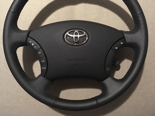

    I replaced the plain steering wheel on my 2005 PreRunner with a leather wrapped one, along with audio controls to complement my updated radio and speaker install.
    I followed this excellent write-up:
    https://www.tacomaworld.com/threads/316944/
    My old cover would not work with the audio controls. I was able to procure just the cover:
    http://srscover.com/product/toyota-sequoia-tundra-4runner-camry-highlander-tacoma-airbag-cover/
    This is much cheaper than an airbag assembly, even a used one.
    I received a new cover in fair time.

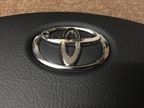

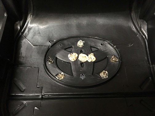

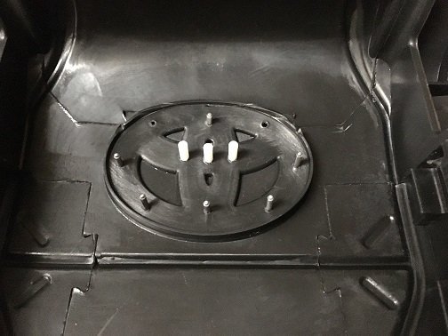

    As with anything from China, it's just not quite finished- the badge must be installed. I wish I could say you simply push the prongs into the holes, but two of the prongs did not line up, so I nipped them off.
    I used a soldering iron to melt them down, simultaneously pushing the badge from the other side.
    Nice and tight
    Fits nice and proper color

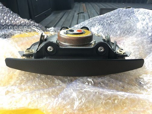

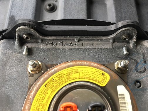

    I removed the airbag at the beginning of the steering wheel install
    Here it is

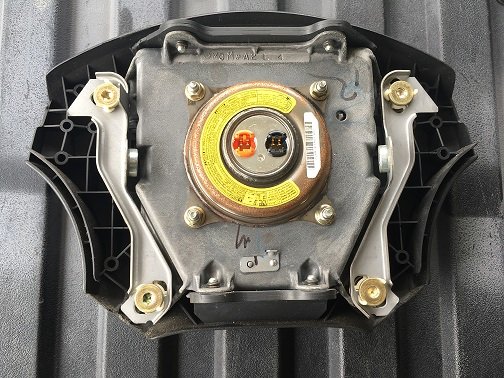

    The side brackets unscrew, revealing washers underneath

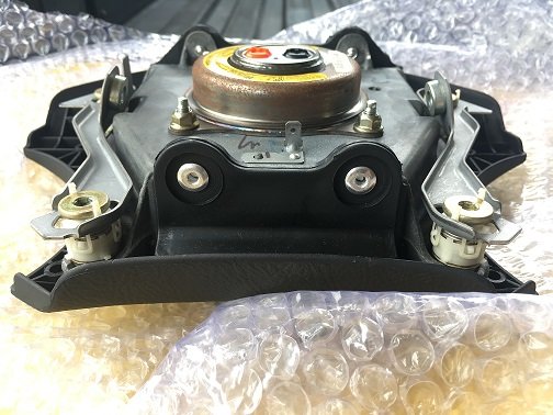

    There are rivets top and bottom
    I drilled them out with a 1/8" drill bit, then followed with a 3/16" bit to remove the top piece

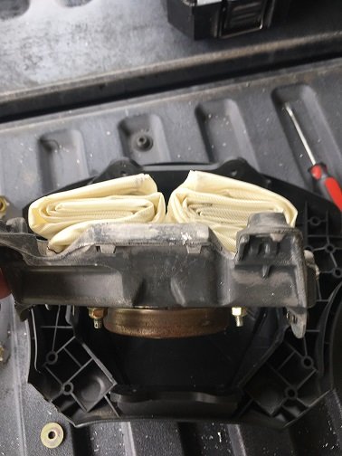

    The side of the airbag also latches into the cover.
    I pried the sides back with a screwdriver while I pealed back the cover from the bottom of the airbag.

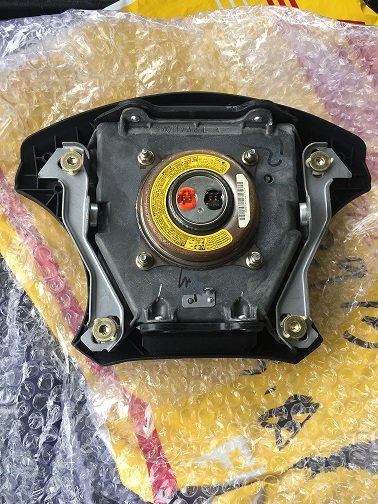

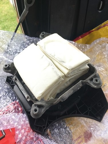

    I had no idea it looked like this
    Installation is easier. I set the bottom of the airbag into the cover, then pushed the top in until the sides snapped into place. Be mindful of the folds of the bag; once I had it half way in I positioned the corners of the bag inward, so not to be pinched.
    I replaced the washers and screwed the brackets back on
    3/16" rivets worked well for top and bottom
    Finished product

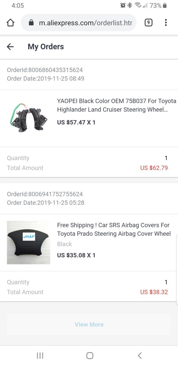

    Anyone got a new link for the airbag cover?
  14. Nov 24, 2019 at 12:44 PM
    outxider
    outxider Never stop exploring. Rest in Paradise Big Bro.
    May 9, 2010
    #36858
    2,081
    Sang
    East Bay, CA
    06 DCSB 4x4
    A few mods here and there and counting....
    I got mine from here.
    US $35.08 10% Off | Free Shipping ! Car SRS Airbag Covers For Toyota Prado Steering Airbag Cover Wheel
    https://s.click.aliexpress.com/e/kwsztk3I

    Thanks guys, I'll let you know how these look and feel.Screenshot_20191125-160544_Chrome.jpg
