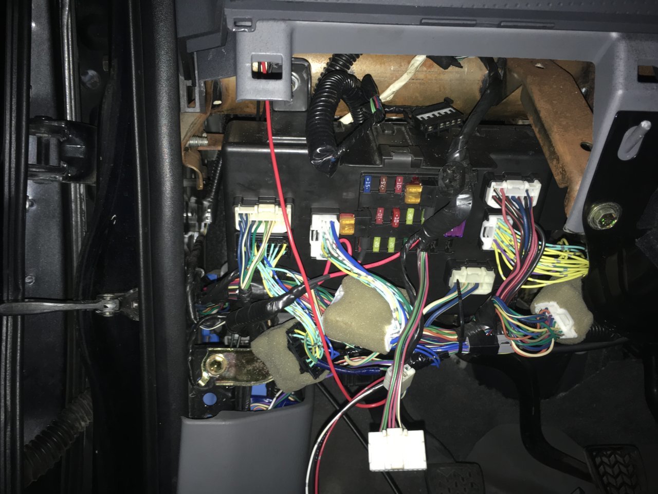

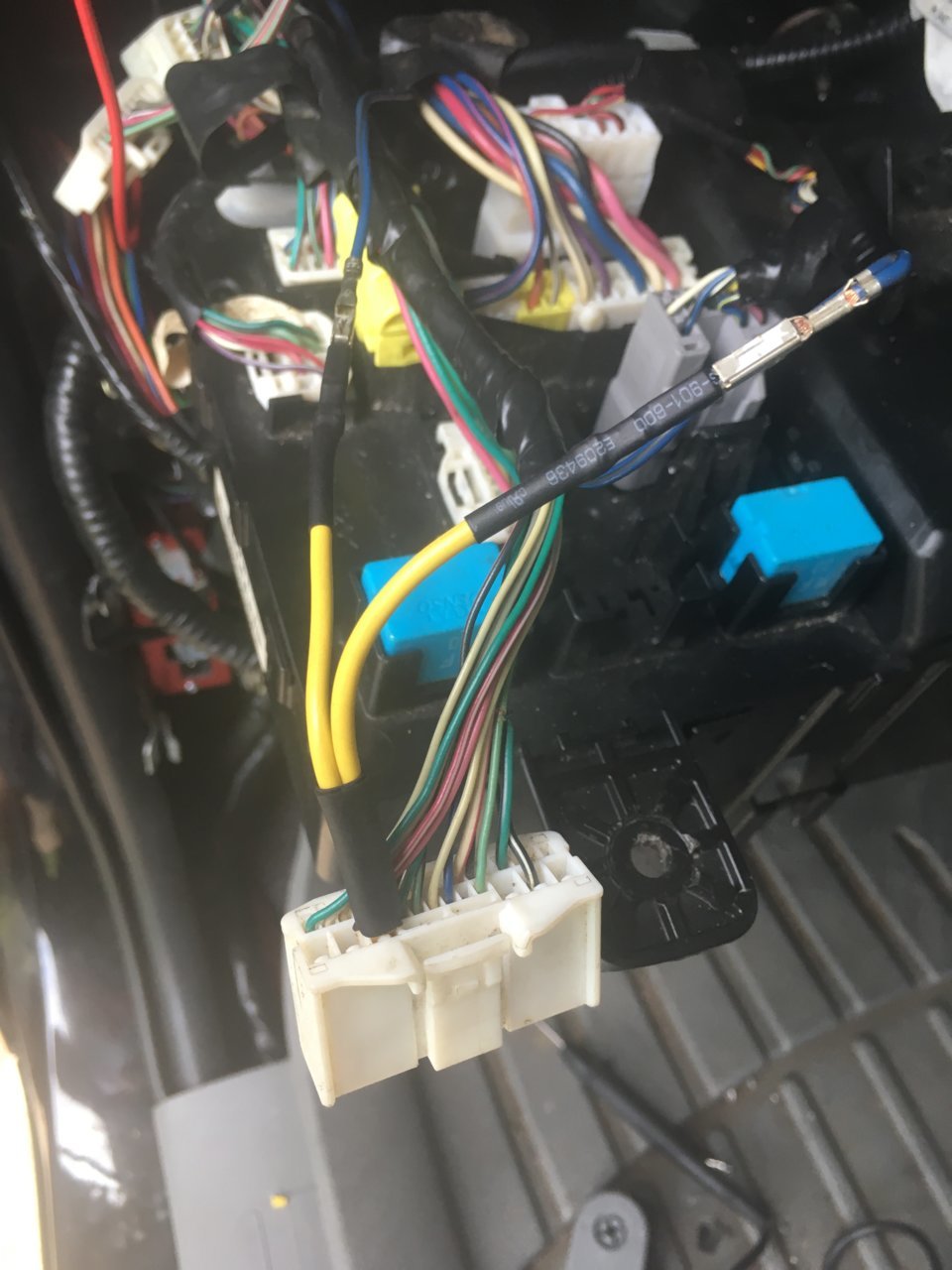

    Some of us with factory wireless door locks want to unlock our doors with a single click of the FOB. This is my solution.
    The Body ECU sends power to unlock the passenger/rear doors with a second press of the FOB, within a defined period of time. I reckoned if this second wire were to be tied into the driver's door wire then it would unlock at the same time.
    I traced the culprit wires with the wiring manual and a multi-meter, and I found they are at two separate connectors on the back side of the Body ECU (beneath steering wheel). I de-pinned them, joined them with a Y-connector I made, and plugged this connector into the driver wire's location.
    ******* Tutorial *******
    Remove the panel under the steering wheel, the Body ECU is the chunk of plastic with all the fuses. There are two nuts and a screw holding it in place- remove those and tilt it forward to gain access to it's back.

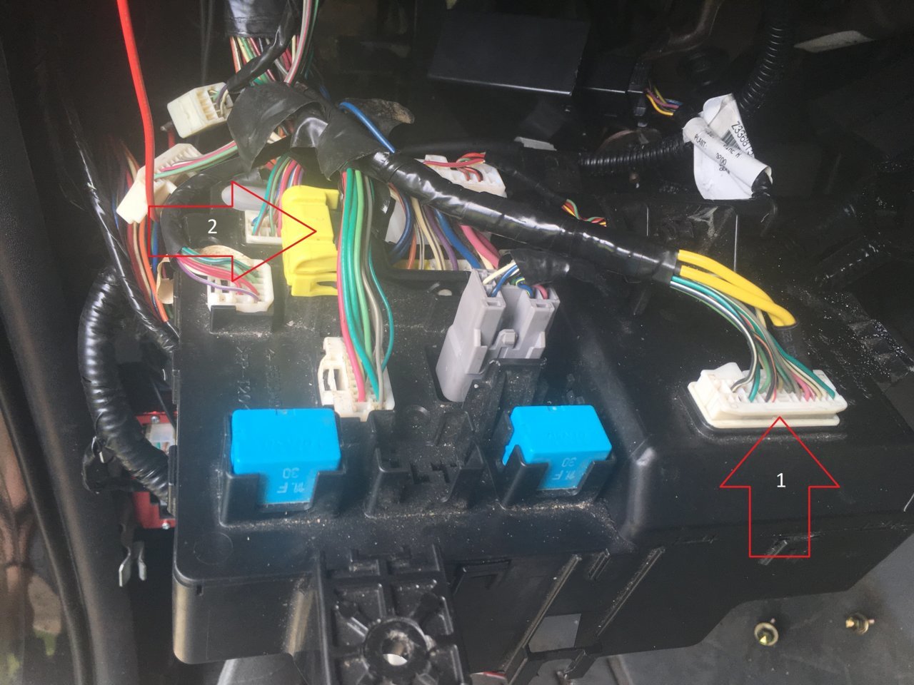

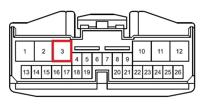

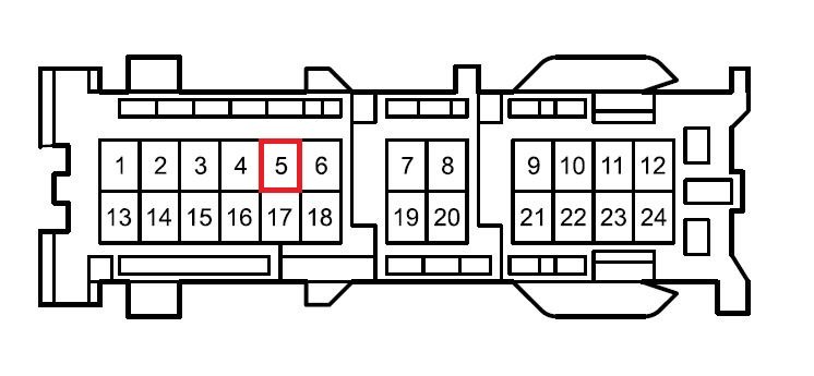

    Connectors labeled "1" and "2" have the two wires we need, one in each. Connector 2 has the yellow piece as a secondary safety to keep it locked into place.
    Both wires are dark blue with a black tracer. Connector 2 has two with this color scheme, we want the smaller of the two (same gauge as the one in Connector 1).
    I'm not going to give a tutorial on how to de-pin.

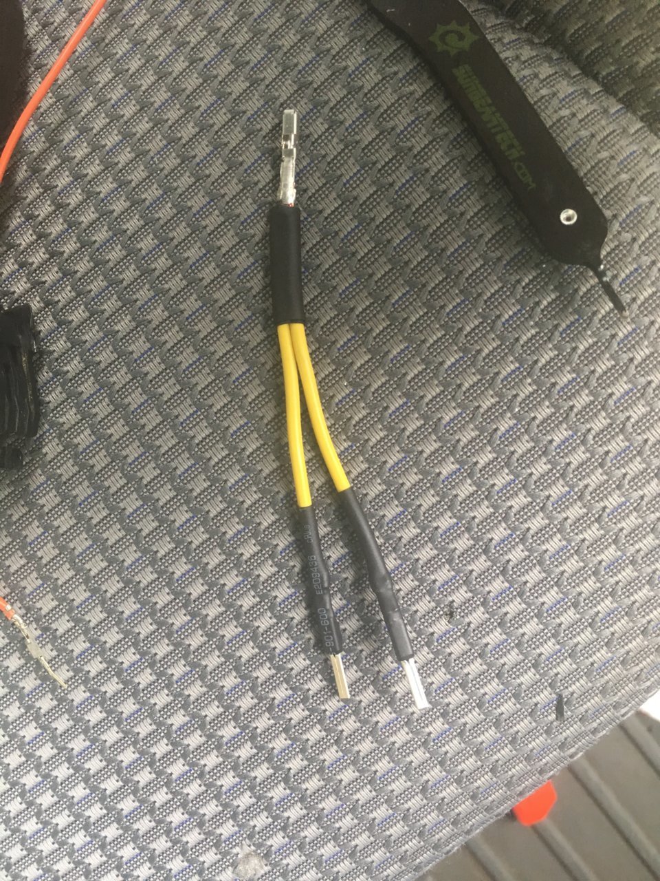

    Y-Connector

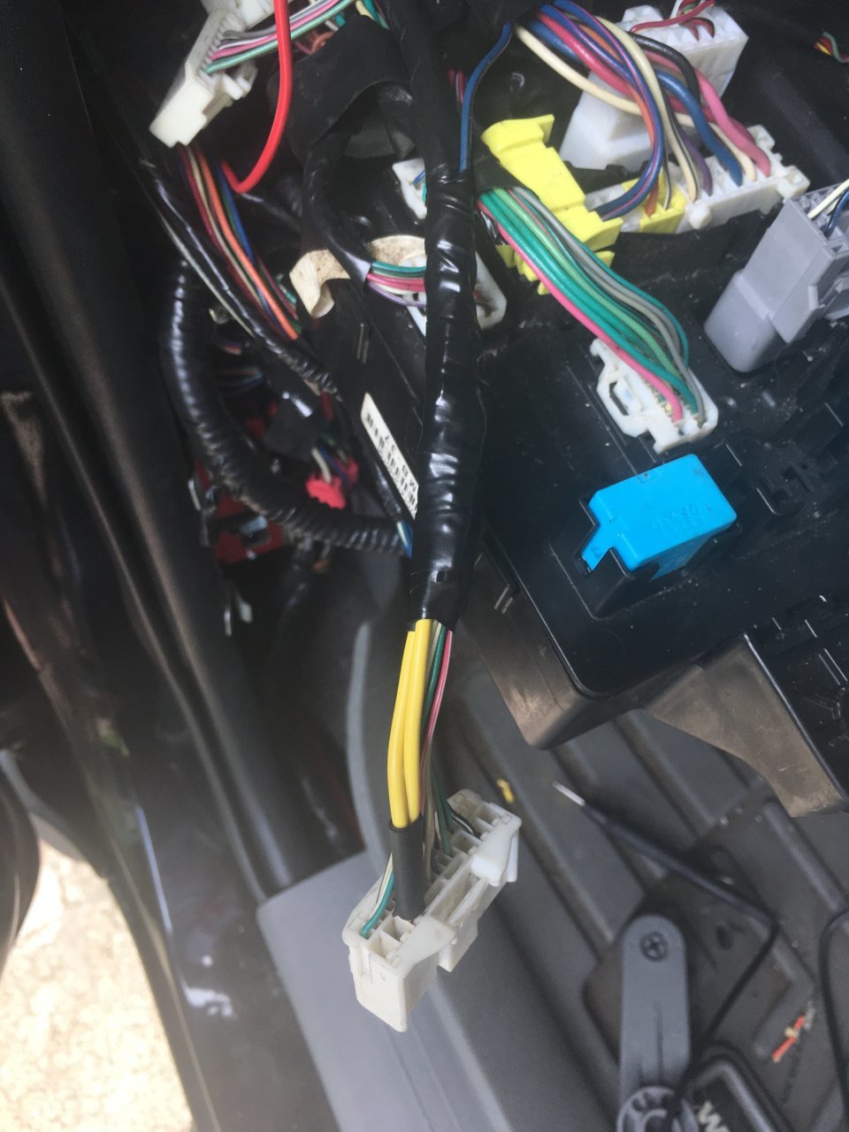

    Join the wires together and insert back into Connector 1
    Secure with tape
    Plug Connector 1 back into the Body ECU
    Finished

    I recommend disconnecting the battery before doing this.
    The FOB in the video is obviously not factory, but the system is.

    @05Taco4x4 where did you get the parts to make that y cable and the pin extractor?
    JimIowa likes this.
  9. Aug 17, 2019 at 12:51 PM
    05Taco4x4
    05Taco4x4 [OP] ToyotaHubs
    Jun 29, 2011
    #59085
    6,257
    2TR-FE Enthusiast
    FJ Tcase, Manual Hubs, 2017 Head unit, Mirror Riser
    Online, the part numbers are there for google search
  10. Aug 17, 2019 at 12:53 PM
    mikalcarbine
    mikalcarbine Well-Known Member
    May 5, 2017
    #218236
    499
    Phoenix, AZ
    2015 AC TRD OR
    In this thread or another? I didn't see any, I'll do some googling either way, that was a very clean y cable

    Male Terminal:
    82998-12330
    Female Terminal:
    82998-12340

    Much appreciated! Is that a specific pin extractor or a generic tool?
  15. Aug 17, 2019 at 4:15 PM
    05Taco4x4
    Jun 29, 2011
    #59085
    6,257
    2TR-FE Enthusiast
    It’s generic, not sure why that one is in the pic must of been doing something else at same time
