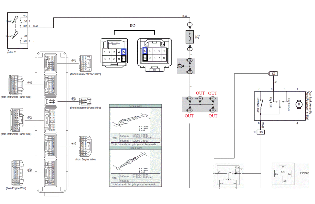

    Some of us want auto locking doors. This is my solution.
    Locking the passenger door with the key provides a ground to a Body ECU wire, which actuates the door locks.
    ******* Tutorial *******
    Disconnect the battery

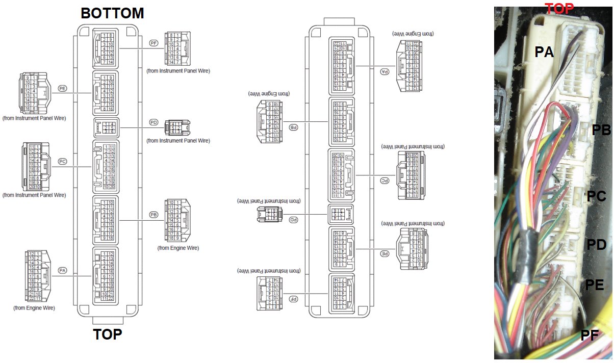

    Remove the glove box and passenger kick panel.
    Behind the glove box is a junction block (J/B) with six connectors plugged in, connector PB is the second from the bottom with 18 wire pin spots.
    Behind the kick panel there are connectors joining the wires from the door harness to the body main harness, IK3 is one of these with 10 wire pin spots.

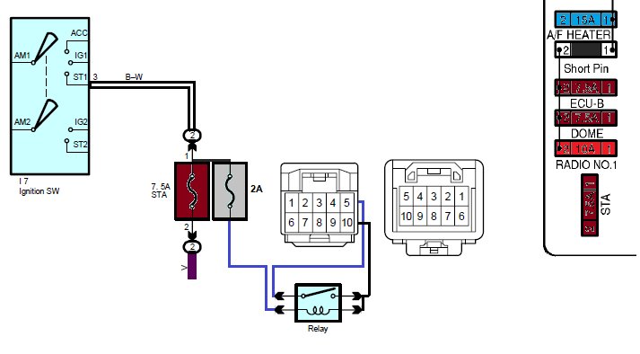

    Refer to this picture and wire in a SPST relay.
    Start 12v
    Manual: PB pin 9
    Auto V6: PD pin 3
    Auto 4cyl: PA pin 11
    SPST Relay
    Pin 87 - IK3 pin 10
    Pin 86 - IK3 pin 10
    Pin 85 - Start 12v
    Pin 30 - IK3 pin 5
    Finished
    :hattip:
    Note:
    We're basically tricking the Body ECU into thinking we're locking the door from the outside- it has logic built into it, so:
    1. If any door is open during starting they will immediately unlock after locking.
    2. If the driver's seatbelt is buckled during starting the Body ECU will not activate the locks.

    Hood Struts, My version Fogs always ON, Map & Overhead Light Mod,
    PB Second from TOP
