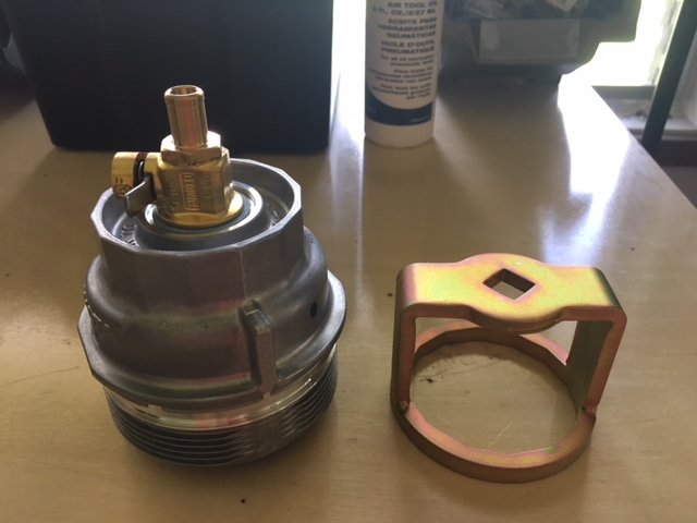

    This mod is for adding a Fumoto Valve to the cartridge, makes draining it quick and easy.
    Replaces and no longer need to remove/install the plug, plastic nipple and O-ring.

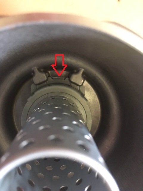

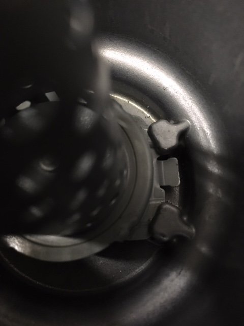

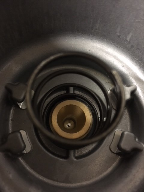

    Disassemble by flipping back the ear and pushing in/rotating the cone.

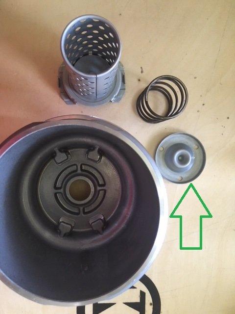

    Lift the cone up and out, followed by the spring and then the valve.
    Dispose of the valve, everything else will be reinstalled.

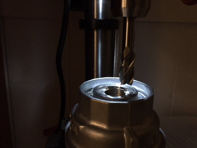

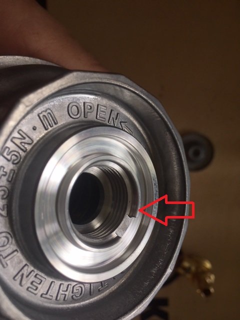

    Machine off the raised lip.
    Tap the thread all the way through, M20x1.5
    Reinstall the spring and cone, flip the tab back down
    Nipple version F-105N is not necessary, plain F-105 is probably best
    http://www.amazon.com/dp/B07D9DW6L3
    http://www.amazon.com/dp/B077NYPG8K
    4 minute oil change on 2TR-FE with Cartridge Conversion
    For those interested in converting their 2.7L spin on filter to a 3.5L Oil Filter Cartridge
    http://www.tacomaworld.com/threads/536996/

    I don’t have a video; many people add a Fumoto Valve to their oil pan to drain oil. This drains the oil before removing the oil cap- no mess.
    Not getting oil everywhere, there’s threads on it

    This thread is to show you how to make the 3.5L oil change easier.
    Tons of people installed Fumoto Valves on their 2nd Gen oil pans, haven’t seen a thread yet about a leak.
    Once you start changing your oil you’ll quickly recognize installing/removing the plastic drain nipple is a pain- you’ll have one less o-ring to install too.
