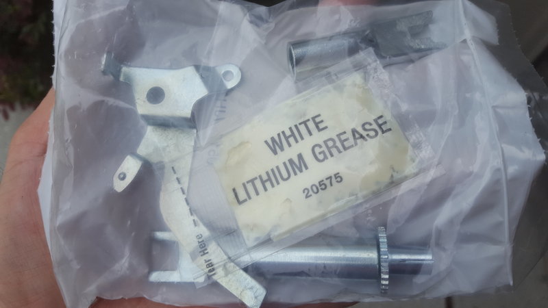

    So I have battled poor braking performance for quite some time. I have put new pads, rotors and ss lines on the front, bleeded the system with new fluid just this weekend and still had a what I call long pedal travel.
    So I took my truck to a local shop today to just check the rear drums for adjustment. Turns out my drivers side brake adjuster is shot and needs replacement. A $9 part at Autozone.
    I will install this week and report back. Hopefully the problem will finally be solved.

    Installed the rear drum star wheel adjuster and finally have my good solid brake pedal back. Also the e brake pedal was nearly going to the floor and now it engages very well.

    Can you elaborate on "shot"? :worthless:
    Quick google search revealed the franchise auto parts stores do not stock this item. Appears to be a low failure item.

    Yes, please post pictures of the bad brake adjuster you replaced. I've been having the same "feel" for about the past 9-12 months. Replaced rotors, pads, front hardware, rear hardware (no brake adjuster though, it didn't come with that part), and even rear brake cylinders. I'll try this soon. Hopefully this helps with having to press the brake pedal down half way before it even bites... I'm still waiting for whats his name to machine and sell conversion plates for Wilwood master cylinders so I can upgrade my master cylinder and front brakes to 4runner rotors and calipers. I just want better braking, stock brakes fade way too much even with no load in the bed.

    I don't have any pictures of the star wheel adjuster that I replaced.

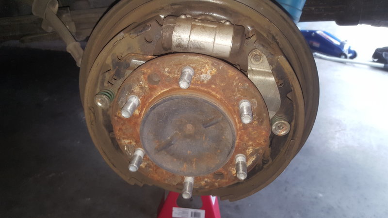

    FYI its real easy to adjust the rear drums... you dont even have to remove rear tires.
    That stated. always use your parking brake and this likely wont happen as it keeps things moving.

    I've found it near impossible to get the brake adjusting tool in the opening at the top of the rear brake backing plate in order to turn the star wheel. You've had success on these doing that?

    Brake adjuster tool?!?! naw two smaller flathead screwdrivers. One to spin the wheel, and one to hold the ratcheting mechanism off the wheel if it was necessary to back off the wheel

    Correct a small long flat head screwdriver works much better. One to tighten adjuster. As stated above if you need to back off the wheel you need two
