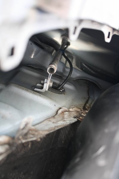

    I've got a question reference grounding that antenna. I had a shop install an aftermarket radio/nav, as well as fix my broken antenna.
    Now, a couple of years later, I heard a vibrating metallic clunking coming from the fender antenna area. Since i was updating the suspension, l also checked the area. Repair shop had broken off multiple fender clips.
    Since I was already going to have to replace the clips, decided to check out the antenna mount inside of the fender. Sure enough, the screw holding the antenna shaft was loose.
    https://www.tacomaworld.com/media/img_39585.305320/
    The screw holds the internal shaft to a metal bracket which is attached to the truck's body. Is this for grounding? I ask since I want to put some Loctite on the screw threads to keep it from vibrating loose again. That might insulate the screw and therefore the antenna shaft.

    If you tighten it up real good it should not loosen. Why cause another possible problem. Be sure it's properly seated and ground areas not all corroded.

    It appears to have loosened up at least once

    It wouldn't be very apparent, as the assembly is pretty buried under the fender and well. Just bad reception and perhaps that tinny rattling I heard occasionally. .
    That said, I just tightened the bolt well, replaced the clips the repair shop neglected to replace, and am going to wait. Pretty sure the HiFi shop wasn't as conscientious as they could have been, which is why it had to be addressed twice.
