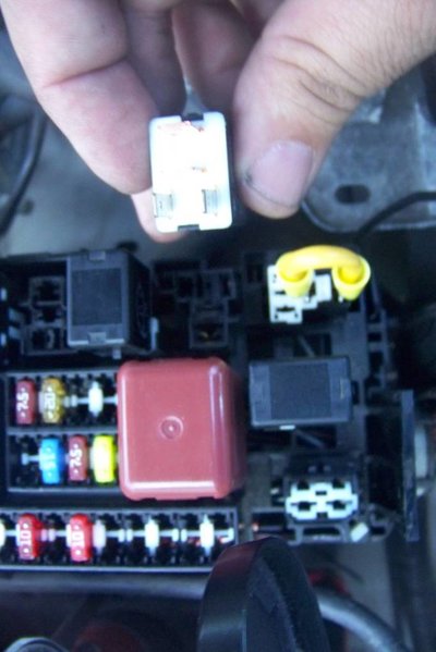

I wanted to wire in some fog lights, I got a little silly. I had already jumpered out my power outlet relay, so I had the extra relay still in my glovebox. I did a little research online the other night and saw that the next relay slot was hot. Pins 1 and 5 were connected to 12v through a bus bar. A .250" female blade fits into the #3 terminal hole, and a .187" terminal fits the #2 pin. I popped up the fuseblock out of its box, clicked the terminals into the slots, and there it is. My next step is to fuse the wire to the foglights, I need a few smaller connectors to fit the Mini fuses, and I will mount them into the extra fuse slots. So far so good, I grounded the wire attached to pin 2 and the relay clicks.
