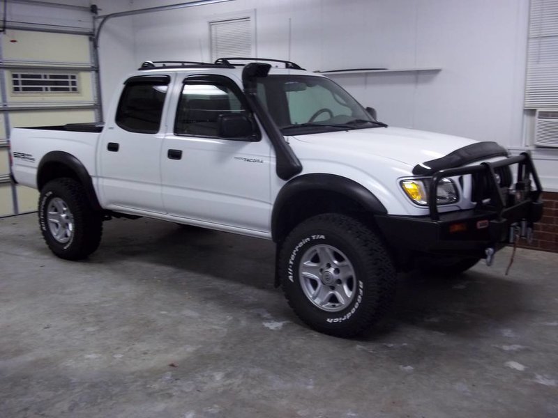

      Heh Guy where I can get a roof rack like yours???
    • wesb1023
      Junk yard. It’s off of a 4Runner. I think I posted some better pics of it up here somewhere years ago.

      Can you send me a pictures please?
      The thing is my car doesn't bring with the holes to put the roof rack.
      How did you do the installation?
    • wesb1023
      It can get pretty complicated if you’re not that mechanically inclined. To start with the rack is too long. It will have to be disassembled and cut to the proper length. Then the mounting holes will have to be drilled into your roof. This should be done with a uni-bit or drill guard as to not drill through the head liner. Then you have the option of using nut rivets or sheet metal screws to fasten it down. Use stainless hardware either way. Silicon on either will prevent water leaks. You’ll get a better idea of how it has to be mounted when you remove the one from the junk yard. Most people don’t want to drill holes, I’ve had zero leaking issues.

      Did you have to run wheel spacers with these wheels? Also what size tire are you running in this pic? I just found me a set of the for cheap on Craigslist
    • wesb1023
      You don’t have to run wheel spacers, but I have the spidertrax 1.25” spacers and 265-75-16 bfg’s.
