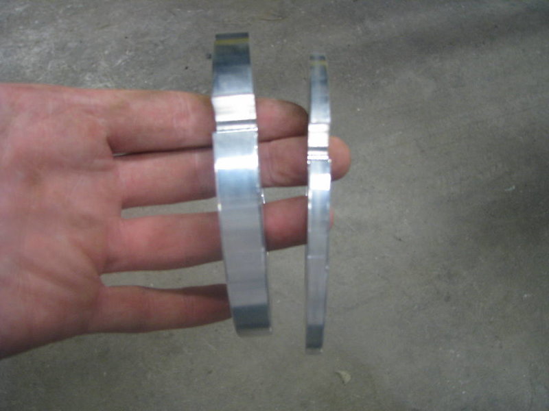

1/2" and 1/4" toytec top plate spacers
Klipp11, Nov 17, 2009
    • 06Bluez
      Did you put the 1/2" on the drivers side for the lean and the 1/4" spacer on the passenger?
    • Klipp11
      i installed the 1/2" on both sides. i was worried i wouldn't have enough clearance for the big tire with only the 1/4" spacer on the passenger side, otherwise you're right, i would have done the 1/2" on the driver side and the 1/4" on the passenger side to level the truck out.
    • 06Bluez
      Are you running stock coils or OME 885's with those top plate spacers? Reason I ask is because I have 5100 and 885 and been thinking about 1/4" and 1/2" on drivers side spacer to give a little more lift because I'm not at a full 3".
    • Klipp11
      5100's + 885 springs
