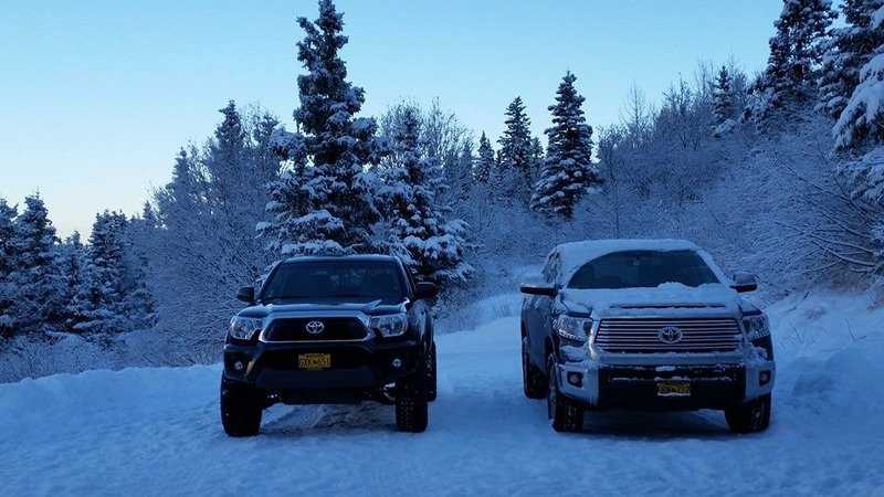

    • @Bnavillus
      what kinda lift/tire set up you running int these pics. srry for all the questions
      300AACTaco likes this.
    • 300AACTaco
      @@Bnavillus
      Old man Emu with 884 coils in these pictures but now I'm running 887 coils and Dakar Leaf packs, and no worries ask away!
    • @Bnavillus
      nice! and thank you, ofcourse i gotta ask why the switch? i understand Dakar leaf packs are highly recommended! you said tires make a difference in ride quality so if i go with something less knobby it'll ride better know that i think about it that totally makes sense!
    • 300AACTaco
      @@Bnavillus I switched because the 884s only provide 2 inches of lift and I needed more to fit the 285 tires, 887's provide 3 inches of lift, I'd go with an all terrain tire if you want a better ride!
