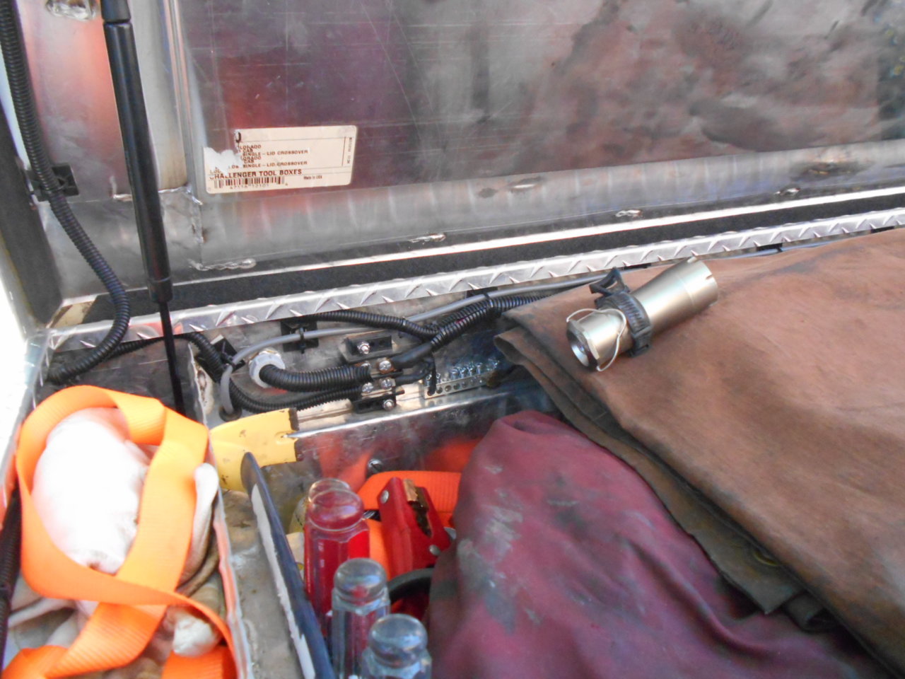

12V / 40 AMP Power into toolbox
#6 welding cable leads from power switch under hood to terminal block inside the box. Powers lighting inside and outside the box, fused Blue Sea 12v outlet as well as Viair 450 compressor.
