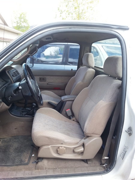

99 Regular Cab w/4runner seats

    • socarboy99
      Nice swap that's the exact thing I was thinking about doing to my '99. What year did the 4Runner seats come out of and did you have any issues mounting them in your truck?
    • markmb45
      Seats are from a 97 runner. I had to swap the outer front mount for a Tacoma mount. Cut the rivet reattached with a bolt and welds. Also swapped the seat belt latches. The 4runner latches were different. Not to difficult to complete.
    • socarboy99
      Great, thanks for your replay your install looks great
