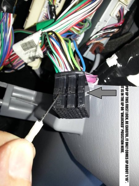

Pop up this first lock, be careful, it only comes up a little bit. It is in the UP or "Unlocked" position here.
