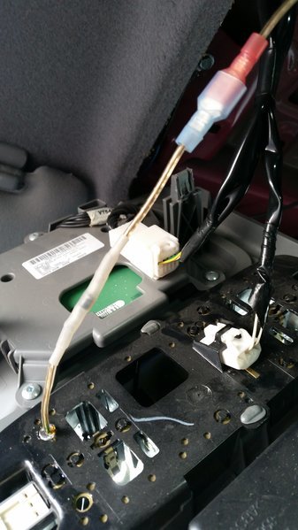

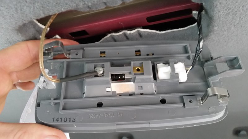

How to have the map lights come one with the dome lights (wire a diode between map and dome, with the line toward the dome).
