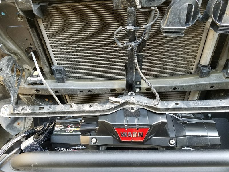

      Warn Winch 10-s Platinum install, removed the center radiator support and drilled out the rivets. Placed a small piece of adhesive velcro (fuzzy side) on top of the winch. The lower radiator support sat nicely on top of the Warn control box. The velcro served as an "anti-rub" / "anti-rattle" mod.
