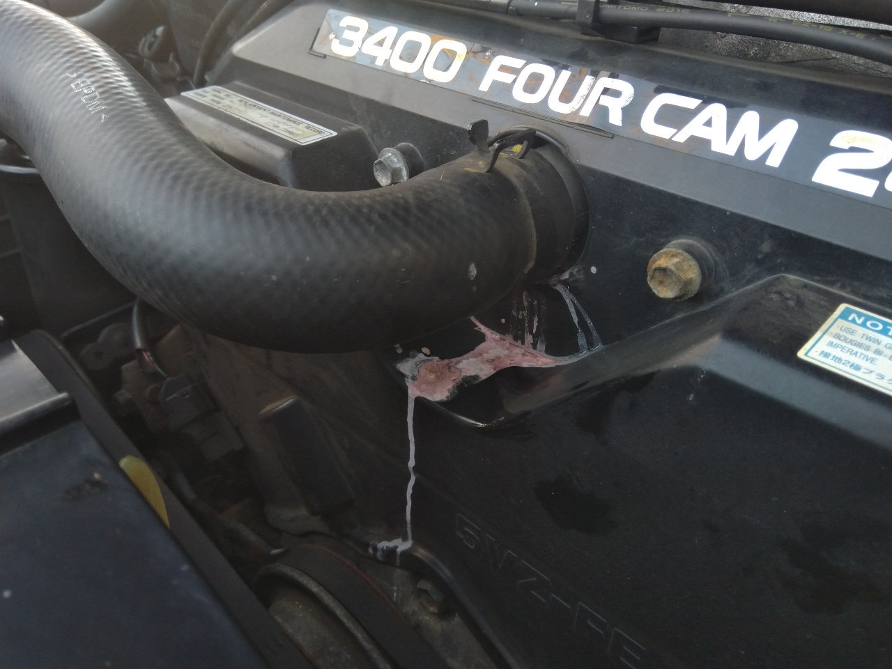

After changing my oil I noticed some coolant leaking from my upper radiator hose. I cleaned it up and watched it for a few days, but it kept leaking.

      i had this happen to me too last year!
      was headed out of town to KC and checked the oil at the gas station and just pooling up the pink stuff
      had to reschedule trip and await hose from Camelback because local dealer was wanting more than $30 for one!
      did you find what the problem was, why was it leaking?
      mine had a ton of buildup underneath on the metal part it goes into
    • CrustyTaco
      @GQ7227 I think the end of the rubber hose had just been stretched out a bit during the frame swap. It started leaking like 2 months after the swap was done.
