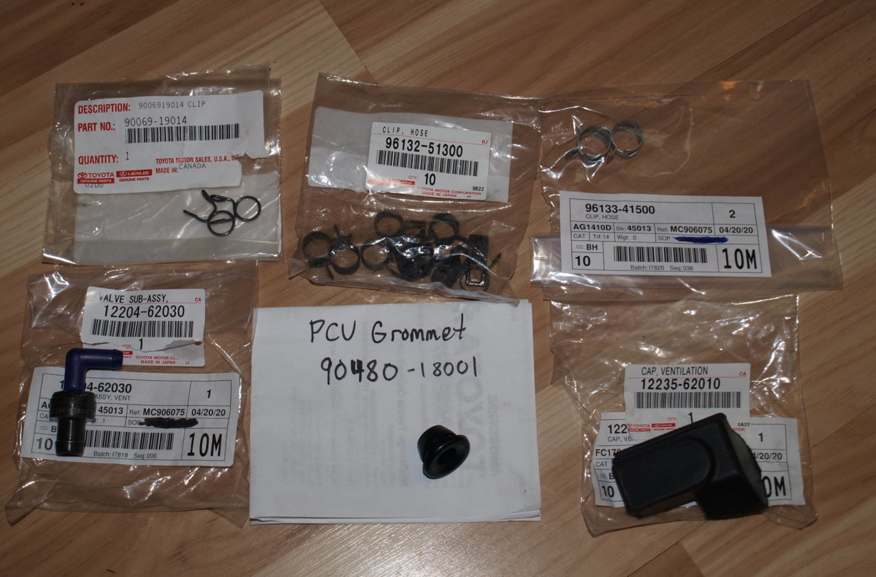

The hoses came from siliconeintakes.com. You need 10ft of 8mm hose, and 2ft of 6mm hose. My hose clamps were rusty, so I wanted to replace them. I also picked up a new PCV valve, grommet, and foam vent cap. On the clamps: 1st bag - radiator overflow, 2nd - for 8mm hoses. 3rd - brake booster hose.
