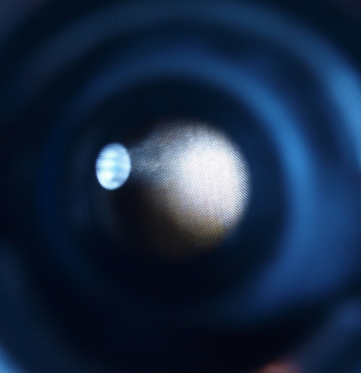

Any time you drain the power steering system, you should check the screen in the P/S reservoir. Mine wasn't too dirty, but I got it nearly 100% clear with some brake cleaner. Timmah's youtube video on this is very helpful.
