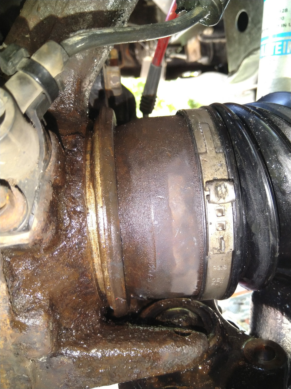

Despite getting a new frame last year, ole crusty still has a few surprises in store for me. The Youtube videos lie, this was supposed to be easy! Separating the spindle from the cv axle burned another hour, and a whole bunch of calories. Time for a lunch break.

      Technique is important for this step. Instead of wasting an hour trying to pry the spindle and CV apart, I should have just put the axle nut back on and given it a few whacks.
