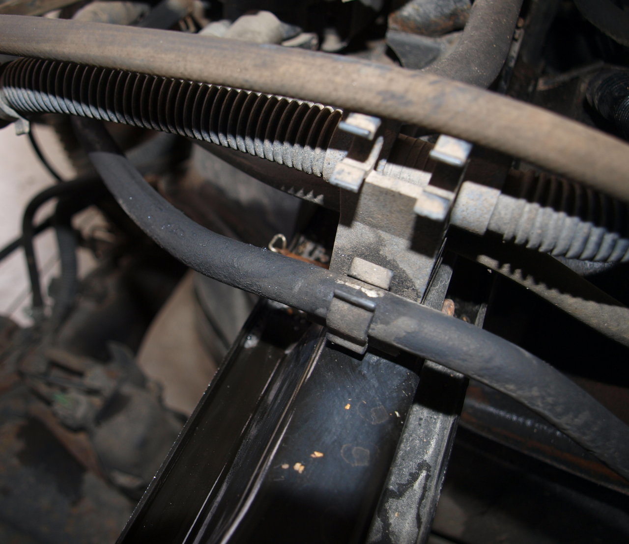

When the truck starts up, it tries to pull a vacuum on the gas tank. Any brittle and decaying hoses like this one need to be replaced. To do the job, you'll need 1/4in, 5/16in, and 3/8in fuel line. There are also a couple of formed rubber hoses you'll want to buy from Toyota. More on that later.
