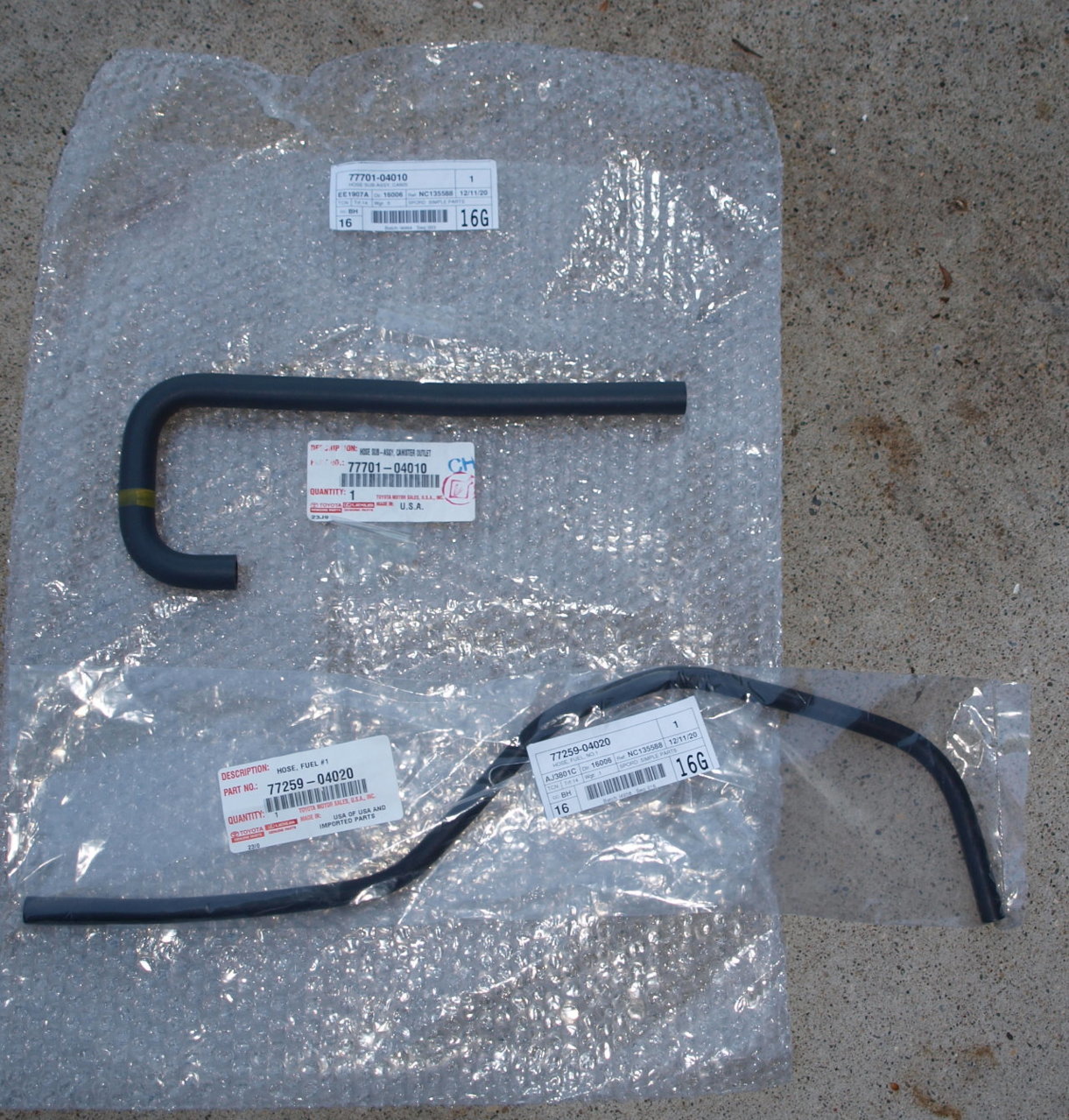

I was able to replace all of the other hoses on the evap system with generic fuel line, however these were a bit unique, and both significantly degraded. Paid Toyota $70 for a new pair. Top hose is a ~1/2"ID hose. The bottom is 1/4" on one end, and ~3/8" on the other end. 77701-04010 77259-04020

      Part numbers:
      77701-04010
      77259-04020

      You have no idea how helpful your photos, part numbers and descriptions are in helping me with my Tacoma. I was having particular trouble finding and identifying replacement hoses for my evaporator canister. You are a great help. Very appreciative you’re a good man.

      @Dogwhisperer Appreciate the kind words, and glad to hear my photos were helpful! I started adding the parts numbers a couple years ago so that these pages could be indexed by search engines. Sometimes the part drawings provided by Toyota don't make it real clear if you're found the right part. If you haven't already checked out partsouq.com, I'd recommend giving them a look. They have the parts diagrams for pretty much every modern Toyota. Reading the diagrams can be tedious, but can make it a little easier to shop around for OEM parts.
