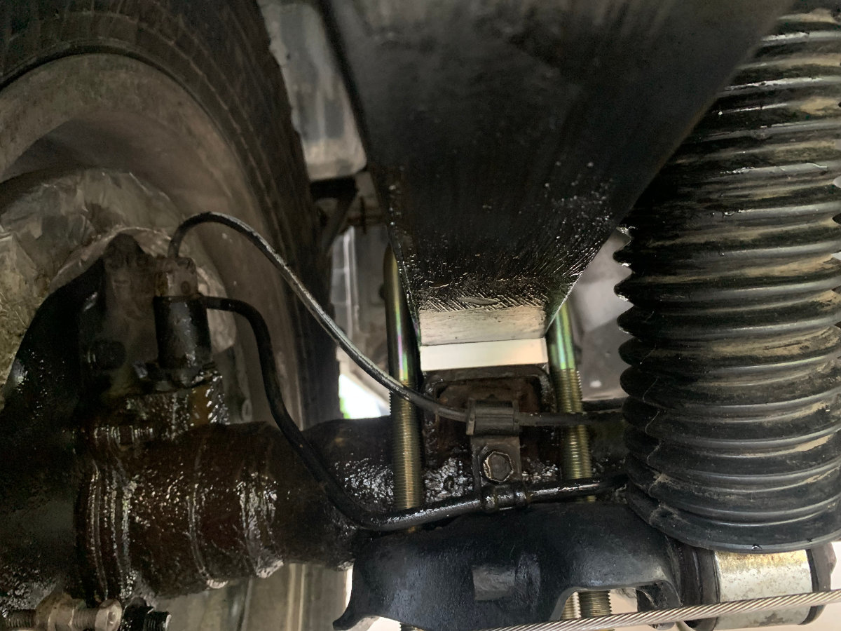

Rear view after getting the shims installed and everything torqued down. Between the carrier bearing and the axle shims I'd say I eliminated 90% or more of the vibrations. May explore a carrier bearing drop in the future, but for now I'm happy.
