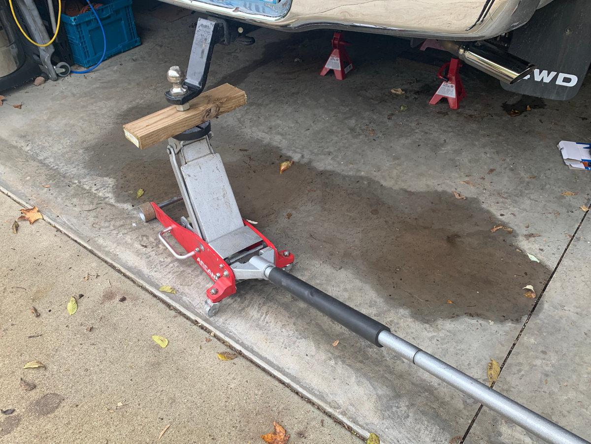

After I undid the old u-bolts, I needed to drop the axle as low as possible and raise the frame to get enough separation to pull the old leaf spring pins. Made it work with the drop hitch and floor jack.
