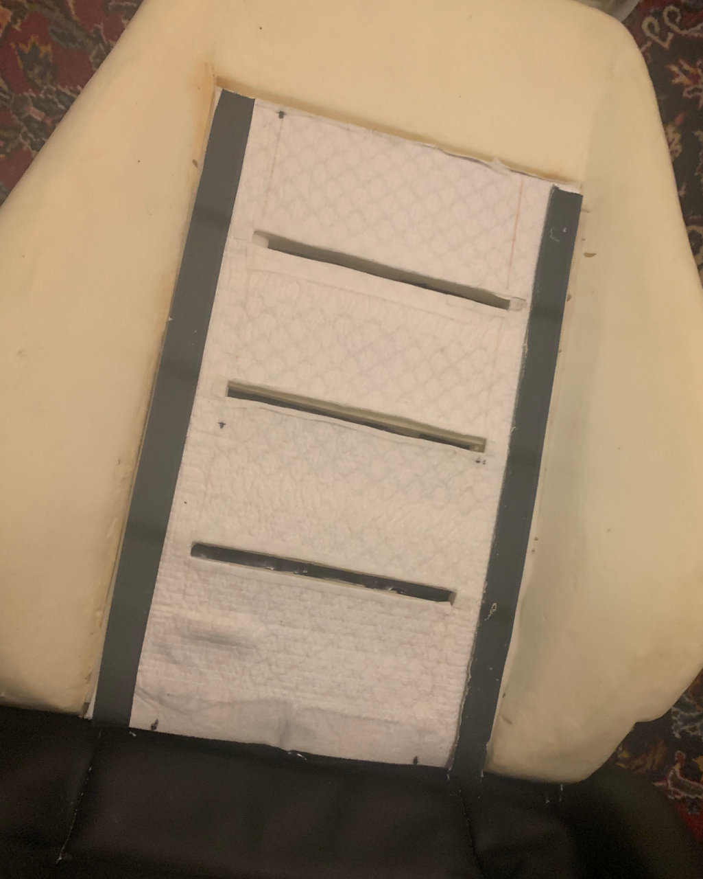

20211127 - Passenger Back Pad
Having the Corbeaus made this job a pain in the butt. Getting this pad installed was probably close to 2 hours of work. Had to cut three holes for the listing seams, glued the velcro that secures the seat covers to the heaters. Insulated the embedded listing wires with electrical tape.
