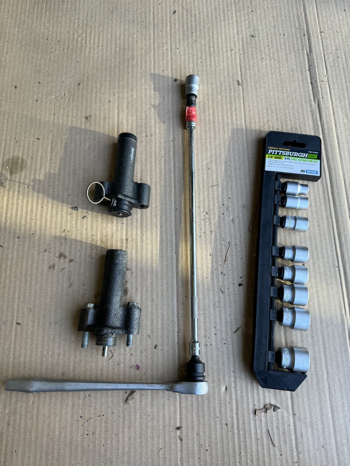

20240406 - Tensioner Removal Setup
Removing the rear timing belt tensioner bolt can be a giant pain. Positioning the socket adapters is tricky and it's a steel bolt driven into the aluminum oil pump housing. This is the setup I used, 3/8 wrench to 1/4 extension, with a taped wobble adapter and a 12mm bolt extractor.
