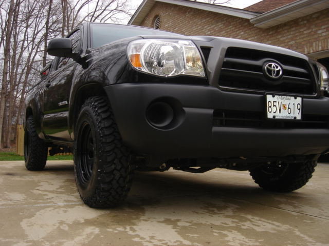

5-Luggers
BFG mud terrain, rock crawler 97s. 30 by 9.50 by 15s

      does this one have a lift? or do those size tires fit without rubbing on the base model reg cab?
    • epa4wd
      Does not look like it has lift, I think that some have confirmed mounting 30 inch tires with very little or no rubbing at all.

      jpinsd truck is not lifted, he removed the black boxes to fit the 30s without rubbing, his wheels are 15x8 with 4.5 inch backspacing
