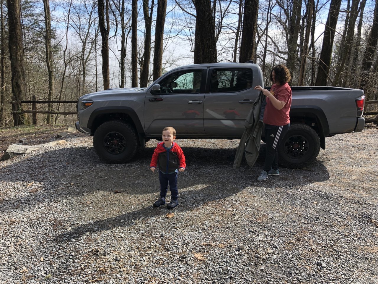

      Hey there, I just joined TW and came across the infamous "how to lift a TRD PRO" thread and was curious if you've had any issue with the Revtek 427ap? Seriously considering this but wanted to poll a couple of people with real life experience on the matter. I appreciate the input!
    • ssmith0480
      @erict14
      Yeah after running it for a month and getting used to it, I really got tired of the stiff ride. I pulled it and installed a $50 top plate spacer off Amazon. Same lift, the ride is about 1000x better. If I did it over I’d go 1.5” top plate spacer and 3 leaf progressive add a leaf. That’s what I’d recommend. The guys saying the ride is the same with the Revtek are full of shit.
    • erict14
      hahaha... perfect, thanks for the honest review!
    • ssmith0480
      @erict14
      No problem! Hope it works out for you. Also...I had to get Total Chaos UCA’s to add more caster. I have 3.5 degrees now.
