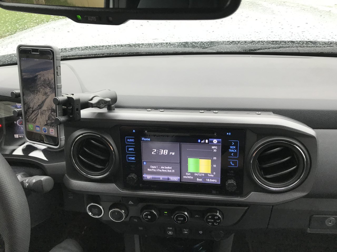

Taco Garage DMM, Hondo Garage Perfect Squeeze 2018 TRD-OR 6AT
8B512628-1307-4E0E-9F92-602CA3D51CAE
KY_Rob, May 4, 2019
    • BadTikiSteve
      Great Mod, who sells this? Thanks
    • KY_Rob
      @BadTikiSteve the top mounting plate above the radio and the mounting ball attached to it is from The Taco Garage, and is called the DMM (https://www.tacomaworld.com/threads...ul-way-to-mount-anything-to-your-dash.553442/).
      The phone cradle (called Perfect Squeeze), the attached mounting ball, and the ram mount arm, is from Hondo Garage.
      You have to remove the bezel from around the radio to drill and install the DMM plate (lots of videos online). I found it pretty easy.
      I also used some shrink tubing around the base of the DMM ball (didn’t like the shiny look), and used some 10-32 button head cap screws in the unused mounting holes. This was separate and not included.
