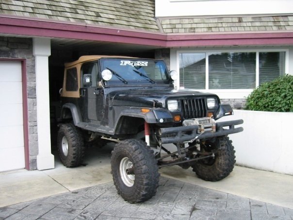

I know it's not a Toyota which is probably why this spent more time in the shop then on the trails, but I built this jeep over 3 years about 15 years ago so all the details are a bit foggy. I know that I did swap the 4.2 litre for a 4.0 litre got rid of the stock diffs for wagoneer Dana 44's with 4.88 gears and Detroit lockers. 8000lb Warn winch with 4" spring lift, 2 inch shackle, 2" body lift and a spring over conversion. Running on 36 swamped sx's
