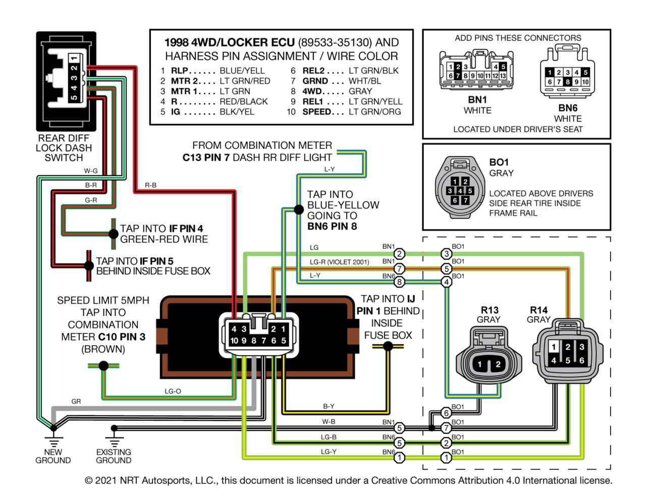

'98 Tacoma E-Locker Components Retrofit Wiring Diagram
I created this diagram after doing a lot of research online, thanks to everyone who shares, couldn't have added the e-locker to my truck without your help.
