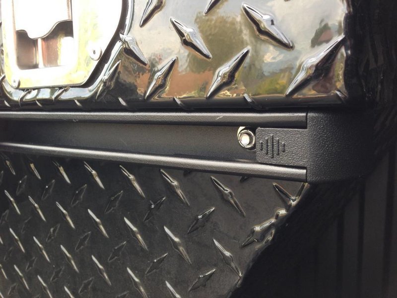

Nylocs on outside and Panhead bolts with fender washers inside; so toolbox tray can still slide side-to-side.
