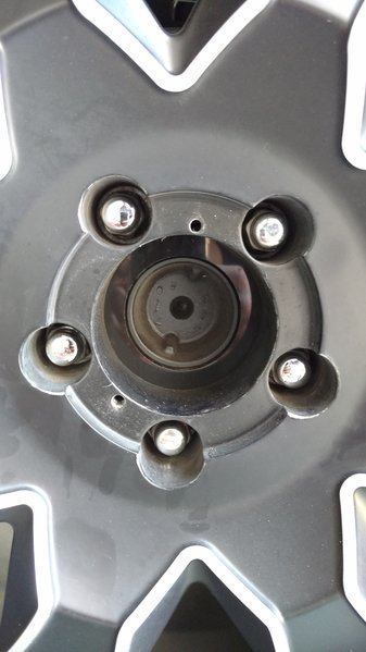

      I took these wheels to the tire shop twice, and to the Toyota dealership because of a shimmy in the steering wheel. Everything checked out fine, all three times the wheel balance checked fine. None of them knew what was wrong... or maybe didn't care to know ha. Anyways, thanks to the internet I ordered some hub centric rings and it is 99% better than the day I bought it. I had to have them custom made so it costed around $65 total, but it was a much cheaper option than new wheels!
