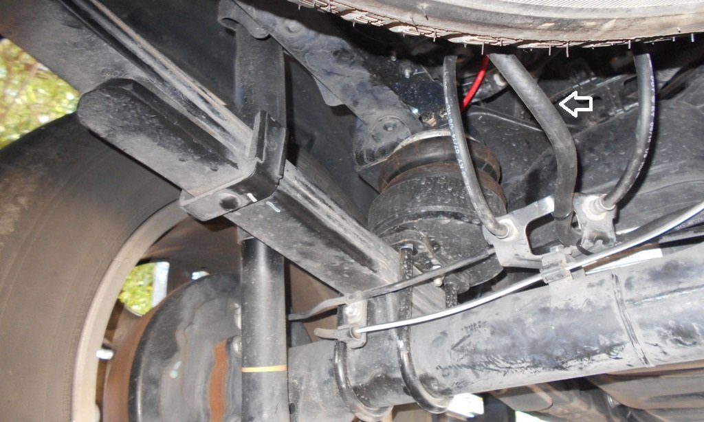

Air Springs And Axle Vent Line
These work well for the purpose of leveling loads that flatten the cheapie "1/4 ton" Toyota leafs. However - they also reduce the allowable travel if they are "aired down" to run light. Without 15 psi in this set-up, they bottom too easy.
