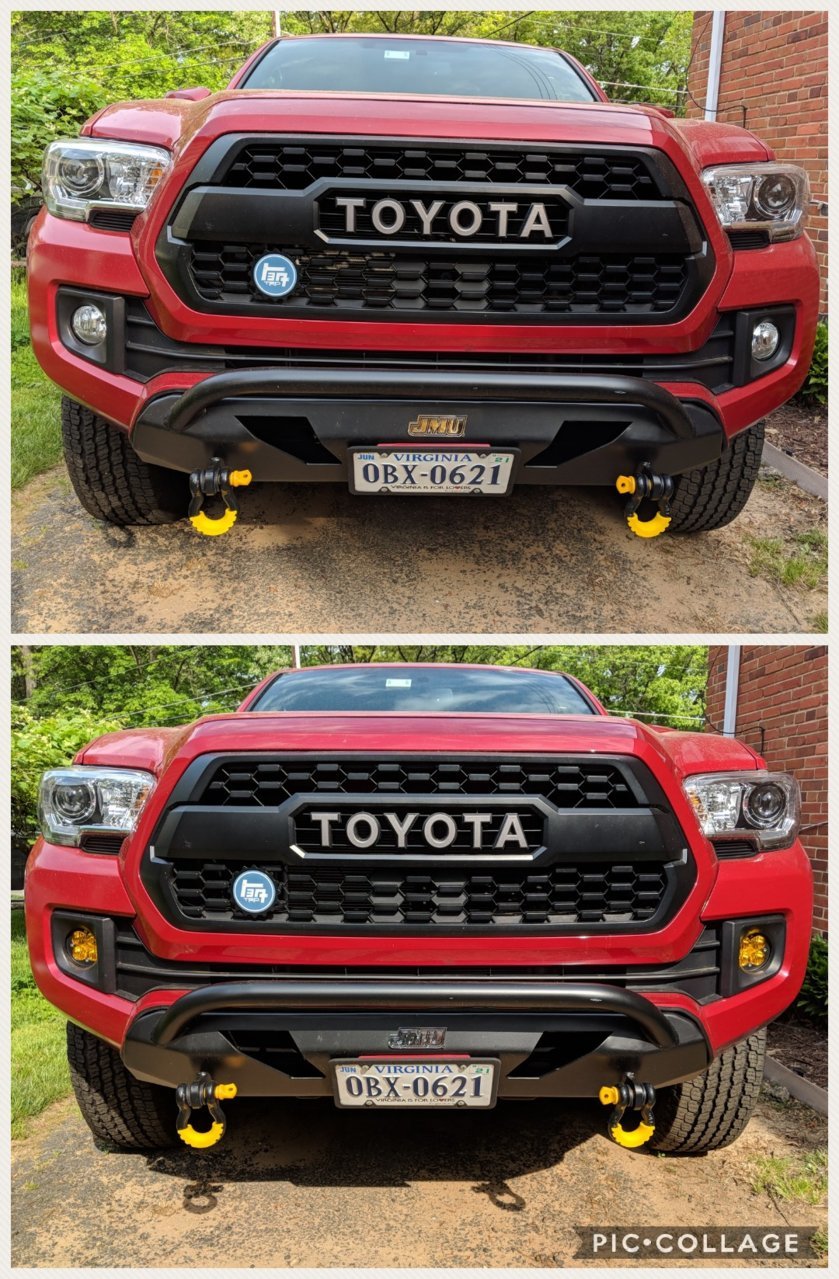

Looks great man! I cant wait to get home and install mine. I like the bumper too, I'm just leery about cutting my bumper. What part of VA do you live in? I am also in VA.
@DubfromGA I think they are great! The light is wide and no higher than the headlights (which keeps them driving legal, i think). There was light fog and a misty night saturday and I think visibility was great.

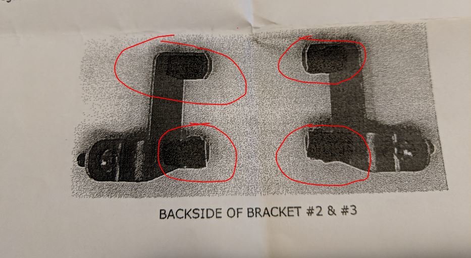

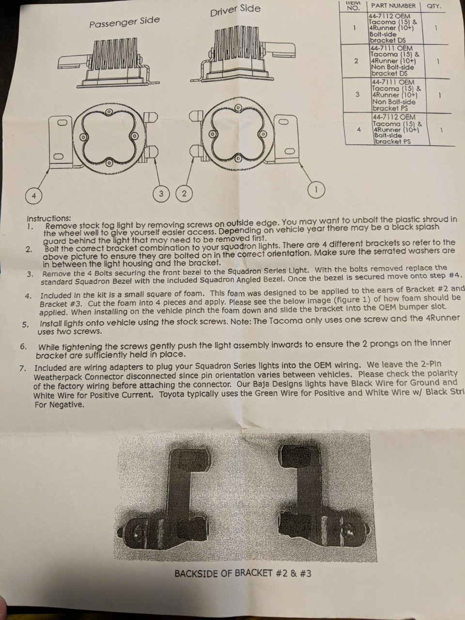

Question...I just want to make sure I’m reading this right. The washers provided go in between the light itself and the brackets?

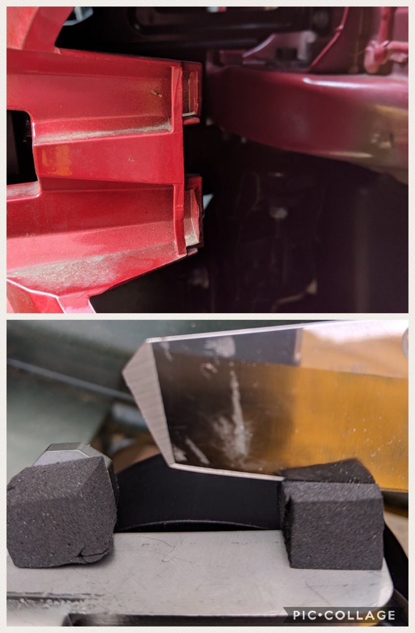

@YotaTRD Here's the way they looked pre-install. I put the pocket kit on, as well as the foam inserts and mounting brackets. See left light. The washer (not seen) is between the bracket and light housing. Hope this helps.
