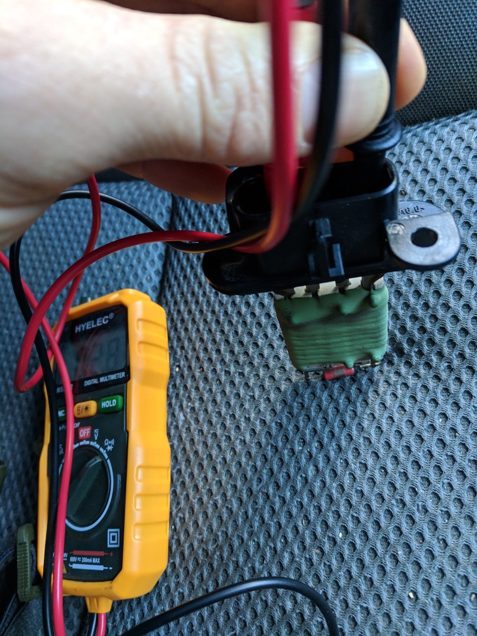

Test#2 Of Orignal Resister

Stock Resister For Blower Passes Current

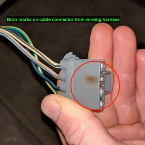

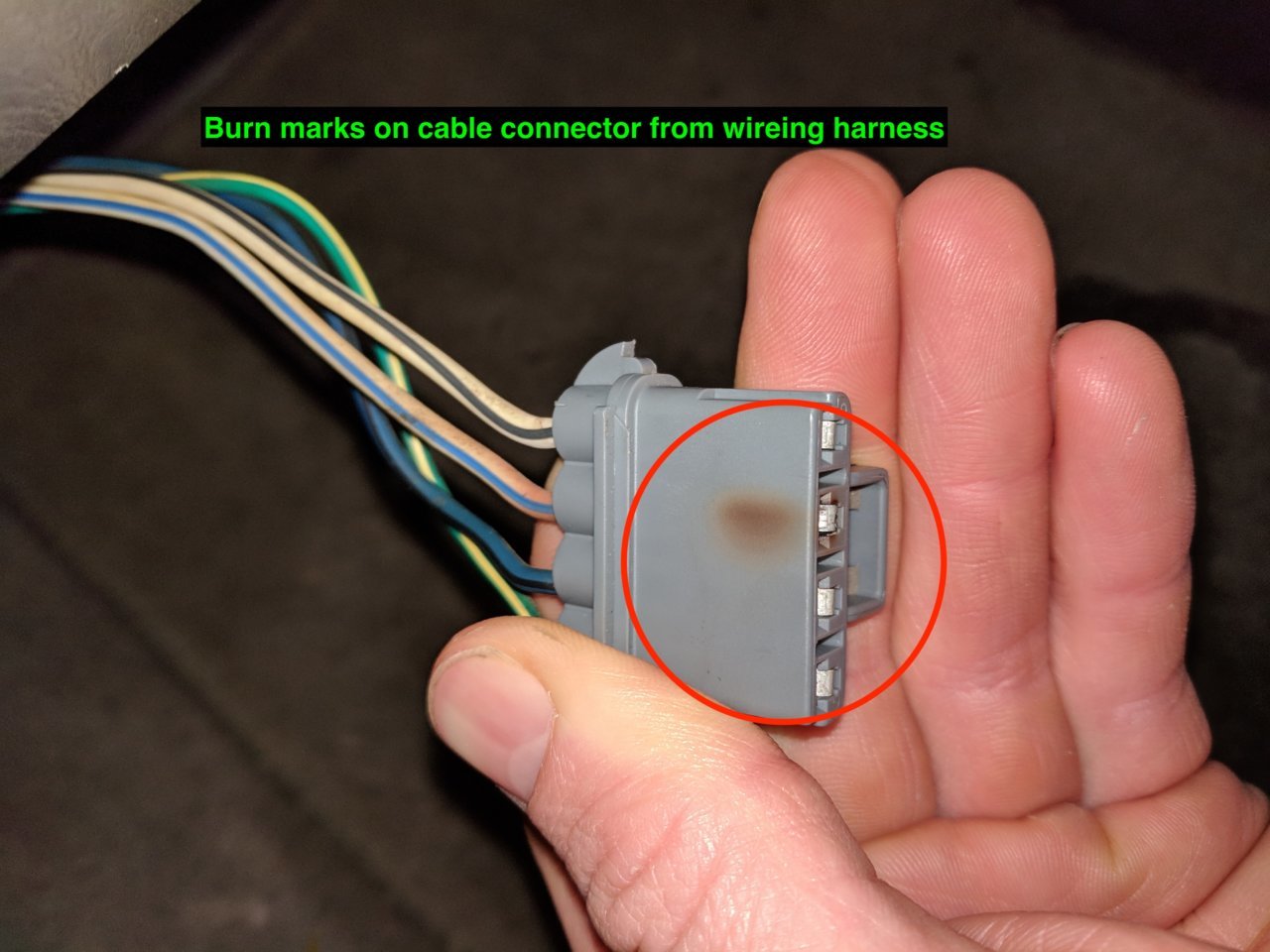

Burnt Cable Connecter

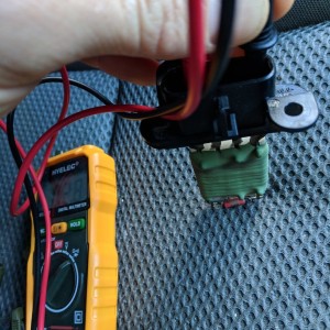

NewReisterDoes Not Work.

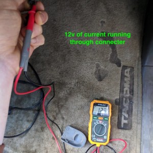

Current Is Running Through Connecter.

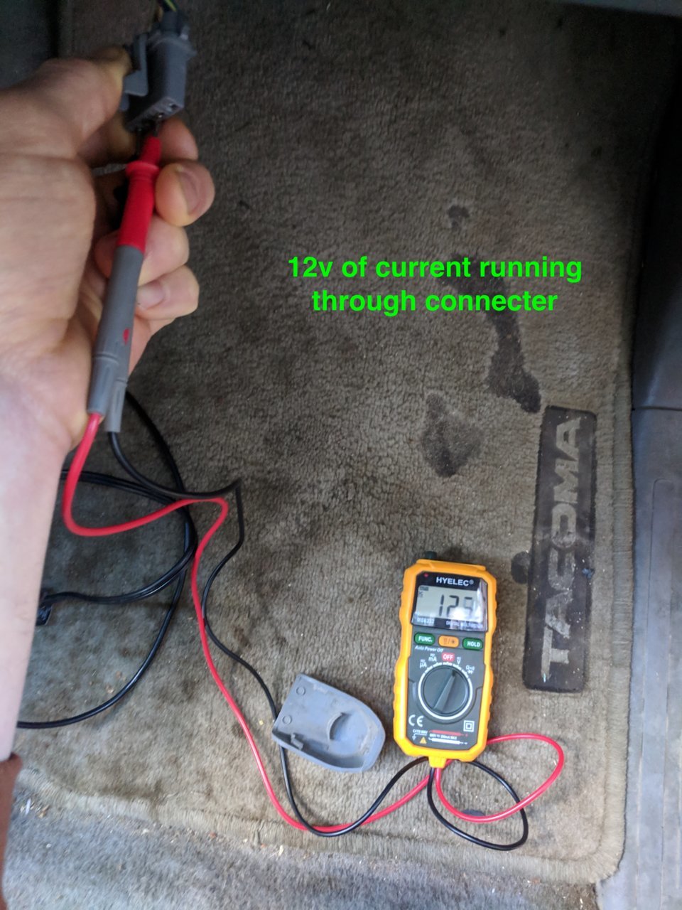

12v Of Current Running Through Connecter
