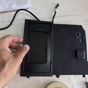

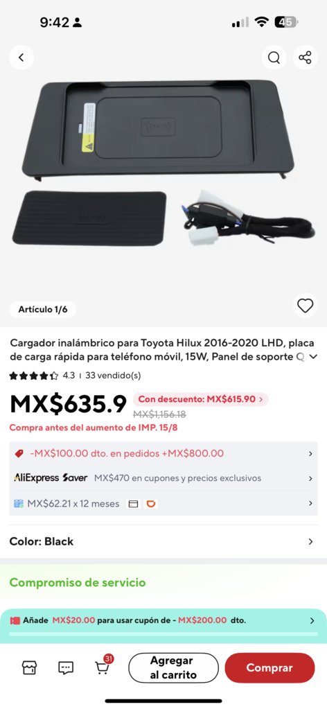

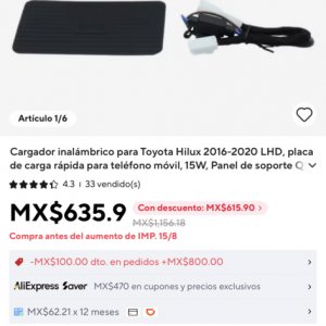

      This is the charger you need to get.

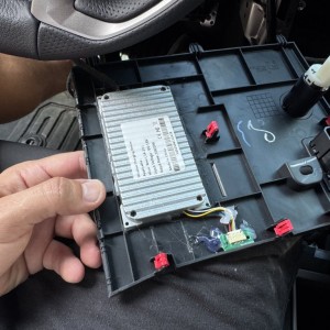

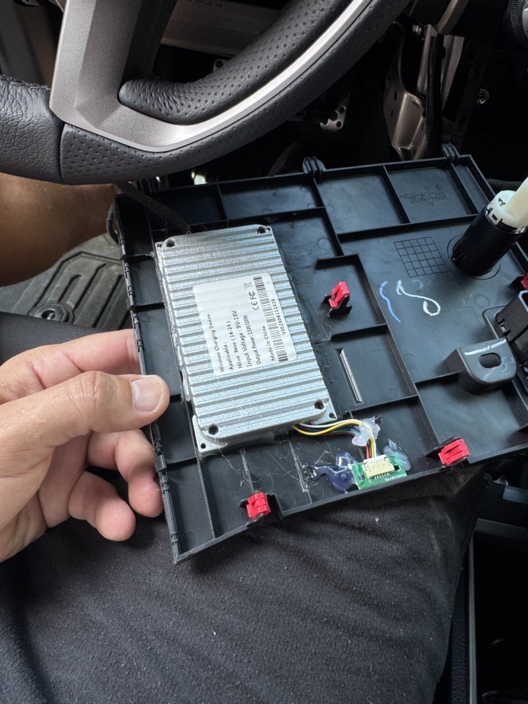

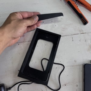

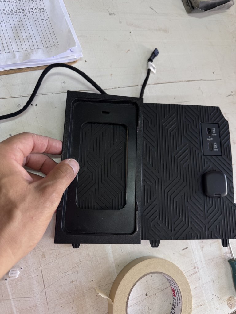

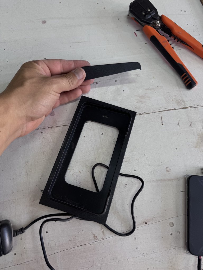

      Then you’ll need to take it apart to make a template, trim the edges of the charger, and stick them to the Tacoma’s charging panel using double-sided tape.
      Use a router with a flush trim bit — that’s how you cut out the panel.
      Then secure the charger plate with a bit of silicone, and connect the harness to the cigarette lighter-style connector.

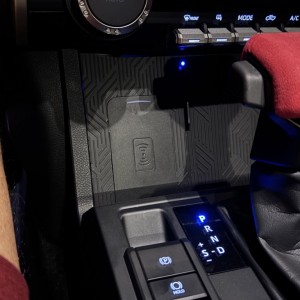

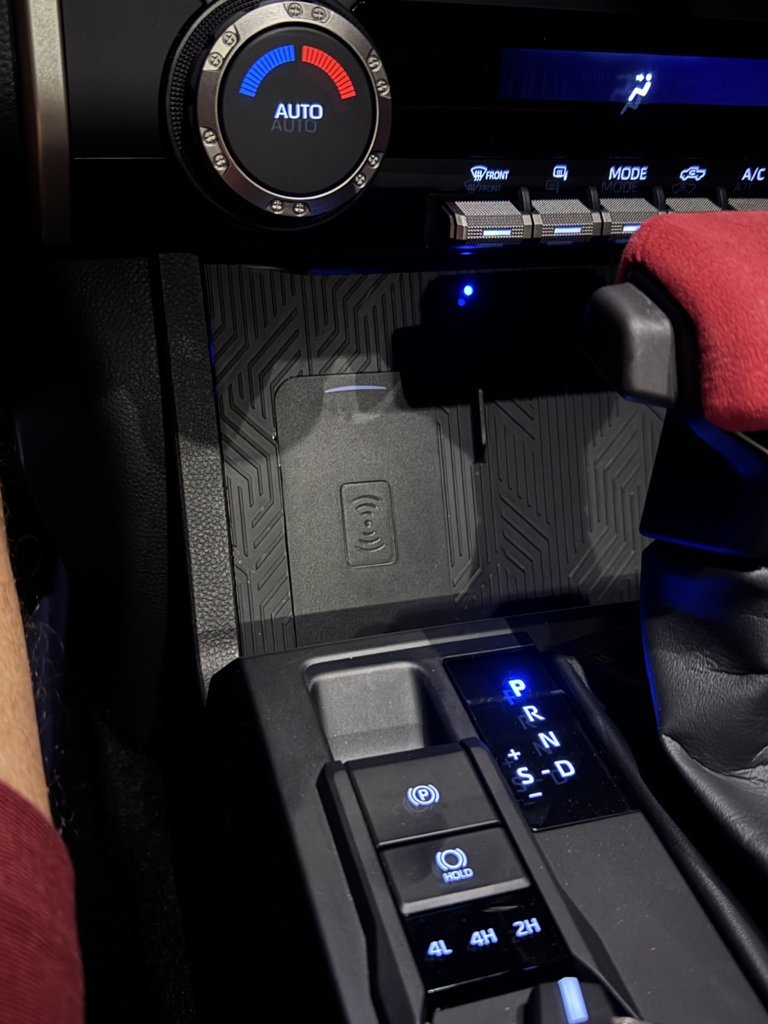

      Here’s the final result. I recommend checking the height of your cut before drilling into the truck’s panel, depending on your phone. For my phones — an iPhone XR and an iPhone 15 Pro Max — the ideal spot was about half an inch above the bottom edge of the panel.
      I forgot to mention you can drill a small 1/8” hole and mount the charge status LED behind the panel. Blue means standby, green means charging. If the LED flashes red, it’s because the panel location wasn’t correct — you can fix it by adding a small spacer inside the charging tray.

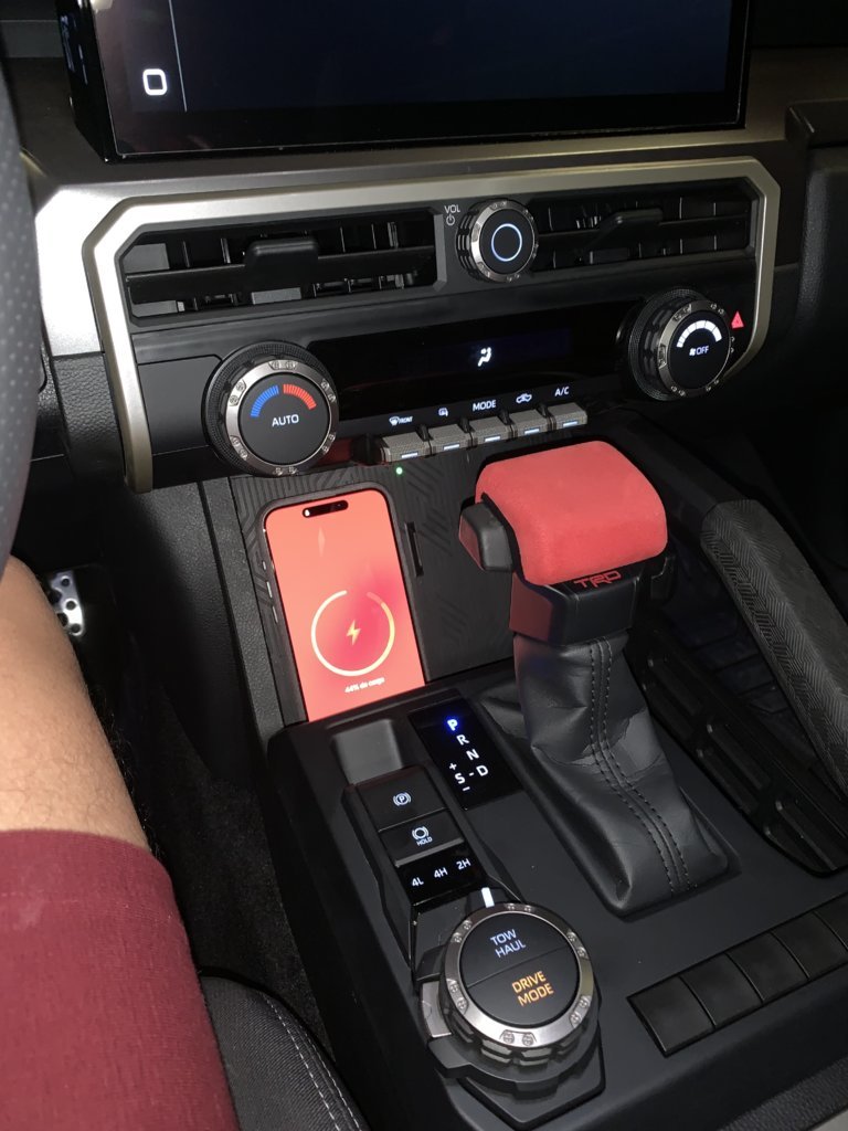

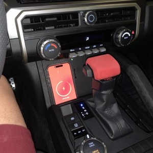

      Here it is charging — I’ve already tested it while driving and everything worked perfectly. Hope this helps someone out. Greetings from Aguascalientes, Mexico!
