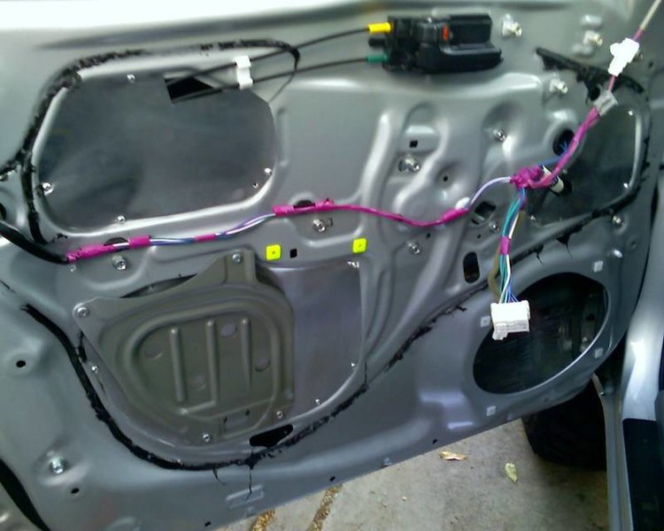

Aluminum Flashing to cover the big holes.
I used aluminum flashing to cover up the holes (fastened with sheet metal screws). I put another layer of RaamMat over the door and put Ensolyte over that. The rear doors go much quicker than the front.
