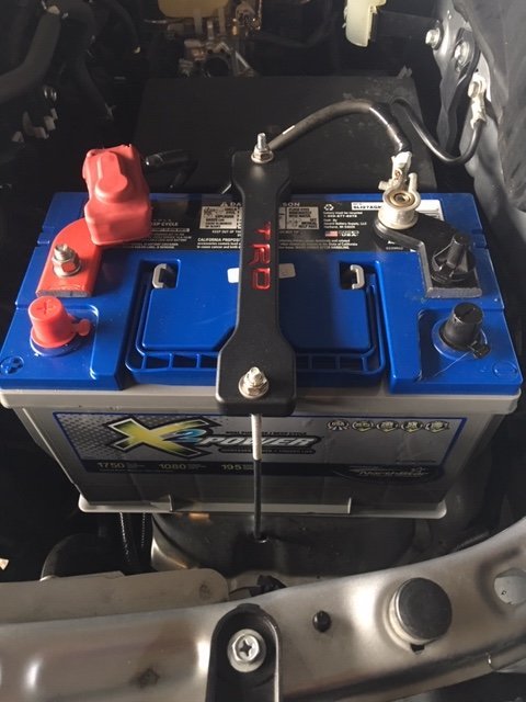

      Factory battery weighed 41 lbs, replacement weighs 68 lbs. Just used a 2nd gen battery tray. It’s a plastic tray just like in the 3rd gens just a little longer and fits the group 27 battery I used perfect. Part #74431-0C020
