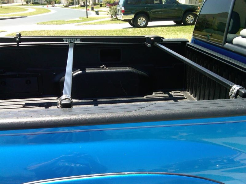

Putting some Thule load bars across the bed using the channels.

      Are those pipe clamps holding the crossbar to the cleat?
    • HEAVY WT
      They are. I did two per corner and went with stainless steel clamps over the normal steel ones. It takes about 5 minutes to take off and the whole assembly is rigid enough that I can just lean it against the garage wall when not in use.
