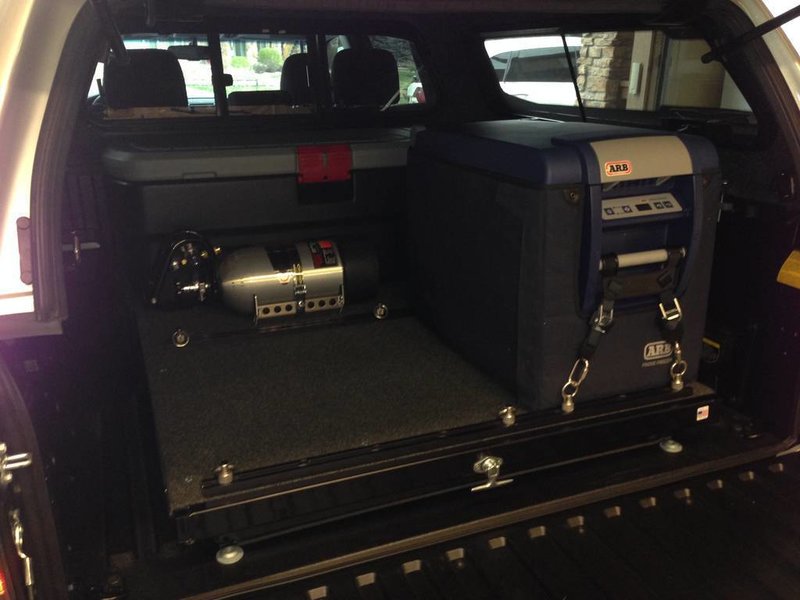

This is how I set up the bed of my 2013 DCSB: Day one - I installed an ATC bed slide, then a Leer 100XQ with a triple 12 volt power module on the passenger side rear to power 12 volt accessories like the ARB fridge. Next, I placed everything where I wanted it, measure twice and drilled once, and mounted the Hi-Lift Slide-N-Lock tracks. I then installed the ARB 50qt. fridge freezer with an ARB tie down kit, a 48 gallon Action Packer with steel ring lashing points and my 10# Power Tank to the slide. That leaves enough room for two (or four, if stacked) 8 gallon Action Packers on the driver side rear of the slide.
