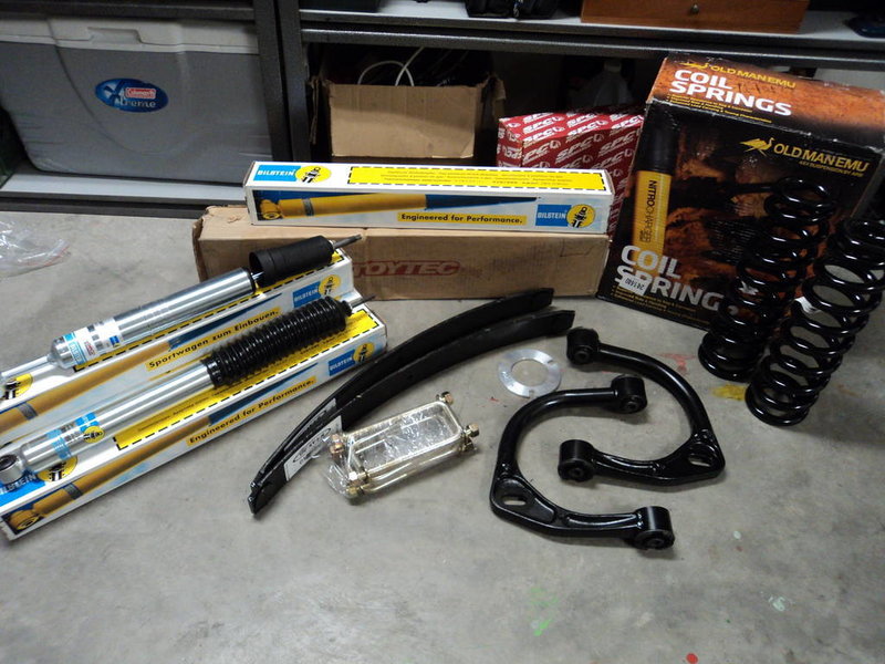

Billstein 5100s, OME 885s, Toytec 1.5" AALs, 7.5" U-Bolts, 1/4 Top Plate Spacer, Light Racing UCAs!!

      What notch of the 5100 did you have it on to run the old man emu coils? aswell what was your total lift when this was all put in?
    • XPOTRON
      They will work with the 0, 0.85, and 1.5 setting but I wouldn't suggest any higher aka 4th setting. Basically I ran mine on the 2nd setting (0.85) for awhile then dropped it back down to 0 when I got my spindle lift
